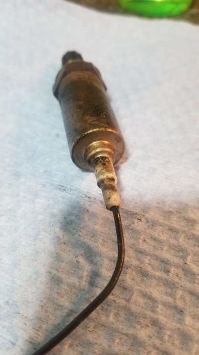

MD540iT 05-26-2022 10:39 PM
was doing a bit of reading on o2 sensors, saying the need outside refernce air, amont other things.... so I decided to get under and have a look just to see whats what.
and I find the outside of the sensor is covered in oil. oil seems to be leaking right on to it. and the end where the wire goes in, has drops of oil on it (rather than just a thin coating.) could oil have gotten IN TO the sensor??
I pulled out the sensor it has a coating of soot on it, but I assume that from running rich, im sure there is slight oil burn, but it can't be bad enough to kill a new sensor in less than 50 miles.

MD540iT 05-28-2022 10:37 AM
Hrmmmmm, I just tested the o2 sensor, by putting a volt meter to it and using a torch. don't know about the accuracy, but it did show up to .9v got the tip red hot.
same with the old (previsou o2) show a .87 volt reading. so I don't know what to think now. (the previous one only had about 200mi on it)
I ordered a new one, this time a walker brand (supposedly made by denso or NTK) (only $15) instead of the 2 bosch.
I cut the wire from the O2 to the computer and put in connector so I dont have to climb under the car to disconnect it, and I think Im going to temporarily install an old "narrow band" A/F meter direct to the O2 wire so I can see what it shows. Im assuming the Wide band and the Narrow band should be somewhat in sync.

MD540iT 06-13-2022 01:18 PM
Originally Posted by RarlyL8 (Post 11706950)
Bad fuel pump will manifest with low system pressure. Idle and cruise will be rich, boost will be very lean.
The Lambda system must be taken out of the equation. Unplug and remove the O2 sensor then adjust the idle mixture to ~13.5 AFR at idle. Check AFR and FP at idle then under light engine load. It should drop to mid-12's light acceleration as vacuum drops then pop up to around mid 14's at cruise.
Finally got a chance to play around with it more.
So I got a new o2 sensor.
But first I hooked up the Narrow band o2 gauge and put a connector in line so i could disconnect the O2 easier.
First I put the "current" o2 sensor back in to see what the Narror Band showed.
once warmed (pressures and A/F set) the NB started dancing back and forth.
NEXT I installed the NEW O2. and heres what I noticed: Started the car, with o2 Disconnected to set the A/F... seems ok, rev the engine, seems normal, (needs some adjustment, but a lot more normal than previously) Connect the the O2, A/F start to go lean towards 16+:mad:
flightlead404 06-14-2022 10:17 AM
Unless you need it for some sort of emissions test then I don't see the value in messing with it. The O2 sensor on the CIS Lambda engines only provided closed loop control at idle when at operating temp. I don't remember exactly where the cutoff was, 1,500 rpm maybe? but beyond that the lambda circuit is disabled.
Disable it, but leave the valve powered/connected. Adjust your idle mixture and airflow to get the 850 +/- 50 rpm with an AFR the engine likes, probably somewhere in the mid-13's, and be done with it.
Once that's done, if you have mixture issues at anywhere other than idle, the problem lies somewhere else. Could be your system or control pressures are off, you WUR isn't working or is the wrong type, leaking vacuum lines, pierburg switches not operating correctly, air leaks in or out of the intake system under different loads, there's a million reasons.
