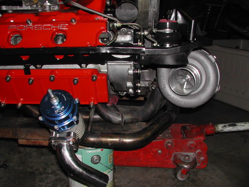

New GT35R Turbo and Tial 46mm Wastegate

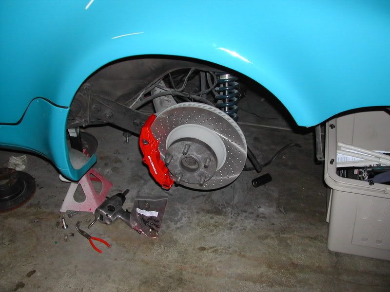

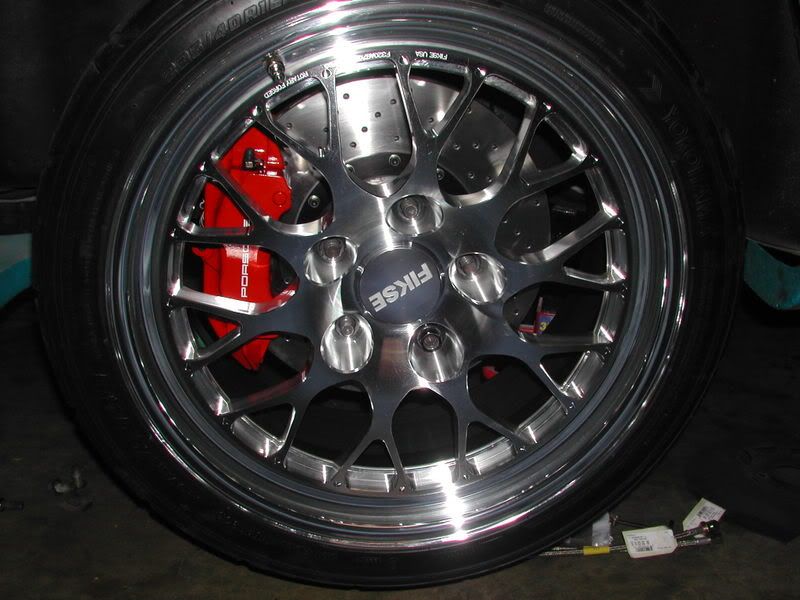

Big brakes before they were on the car. 997 C2S Monoblock calipers front and rear with two piece rotors in the front. 13" rotors front and rear.

Front brakes installed with wheel in place to check fit
Rear brakes installed

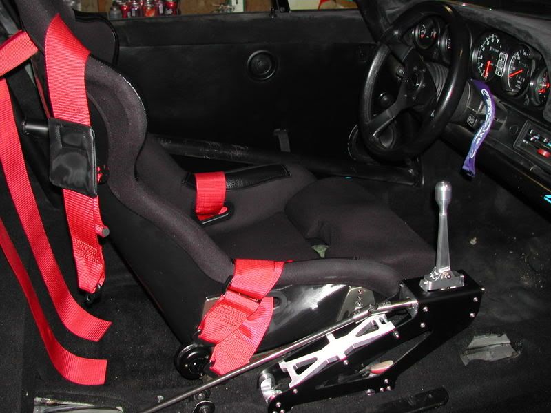

Last, my Hargett precision shifter installed

The question has been asked in other threads but I don't recall it being answered: How do you use your parking brake with that shifter installed?

I answered that question in a couple of other threads but I can do it here too. You simply adjust your e brake cables or shoes (In my case shoe adjustment) a bit tighter so you get full engagement at around 4 clicks. I have done this with mine and you just have to reach around the front of the shifter a little bit to release the button with your right hand while pulling up on the lever with your left to ease the release. Then you just lower the handle.

What type and who makes the shifter? I love it!

It is the Hargett Precision 930 shifter. You can find it and some other cool stuff at www.hargettprecision.com

Like the shifter but what happens to the hand brake?

Read the rest of the thread. It discusses that. Its under the shifter, still there and working.

As an aside are you running a different Brake Master Cylinder with those 997 calipers?

Yeah, It is a 23mm master cylinder. What the application is from I dont know. You could contact Doug at Vehicle Craft for more details. He's a great guy and always takes the time to answer your questions!
