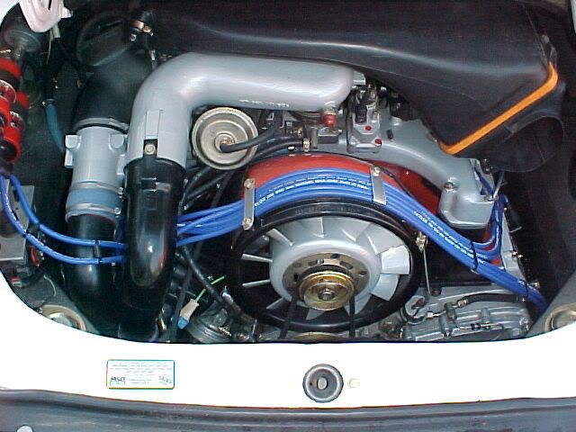

thechiller 06-20-2008 01:35 PM
Well it's done, i did choose the water cooled system and it seams to work very well. The left battery box haved now become a water pump house. I did some aluminium piping on the left side of the car for the water circulation, and the most difficult piping is done with hoses that have a iron spiral in the walls. The expansion wessel and water filling is under the left fender over the battery box and i have to turn the wheels to the right side for filling water. the water pump is an electrick type.
Engine is a 1986 3,3 liter 930 euro version, 300hp, with much larger intercooler capacity, dansk exhaust headers, strait pipes after the turbo, removed smog pump, turbo smart 48mm pro waste gate, manual boost controll. K27 hyflow turbo and the best of course 1973 Martini RSR Racing look.
I now need more hp :) i have ordered new camshafts from drcamshafts.com with sc profile and i do want to go for an new or used efi system with electronic ignition controll. looking for 550 hp. New headstuds is also ordered from pelican parts: Supertec Performance Cylinder Head Stud Kit sold as a complete set, hardware included, 911/911 Turbo/964/993 - 2.4/2.7/3.0/3.2/3.3/3.6L engines
Kjell

RarlyL8 06-20-2008 08:20 PM
Beautiful car Kjell, but you might consider a muffler configuration more like the this. It is straight through with no restrictions. RSR style N/A duals.
EDIT - never mind, I see you want the stockish N/A look with the short valance. Very deceptive!
http://forums.pelicanparts.com/uploa...1214021972.jpg
