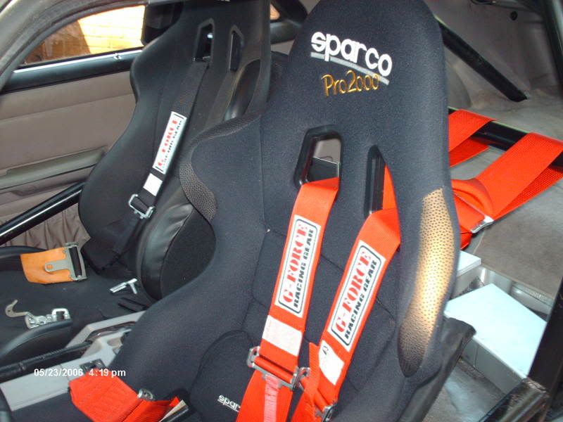

I'm a big fan of Sparco - I couldn't find a better track seat.... pic is from my former IT-E mustang (sold in 2006).

I drove 150 miles non stop in my Sparco Evo's, they are great, very comfy.
