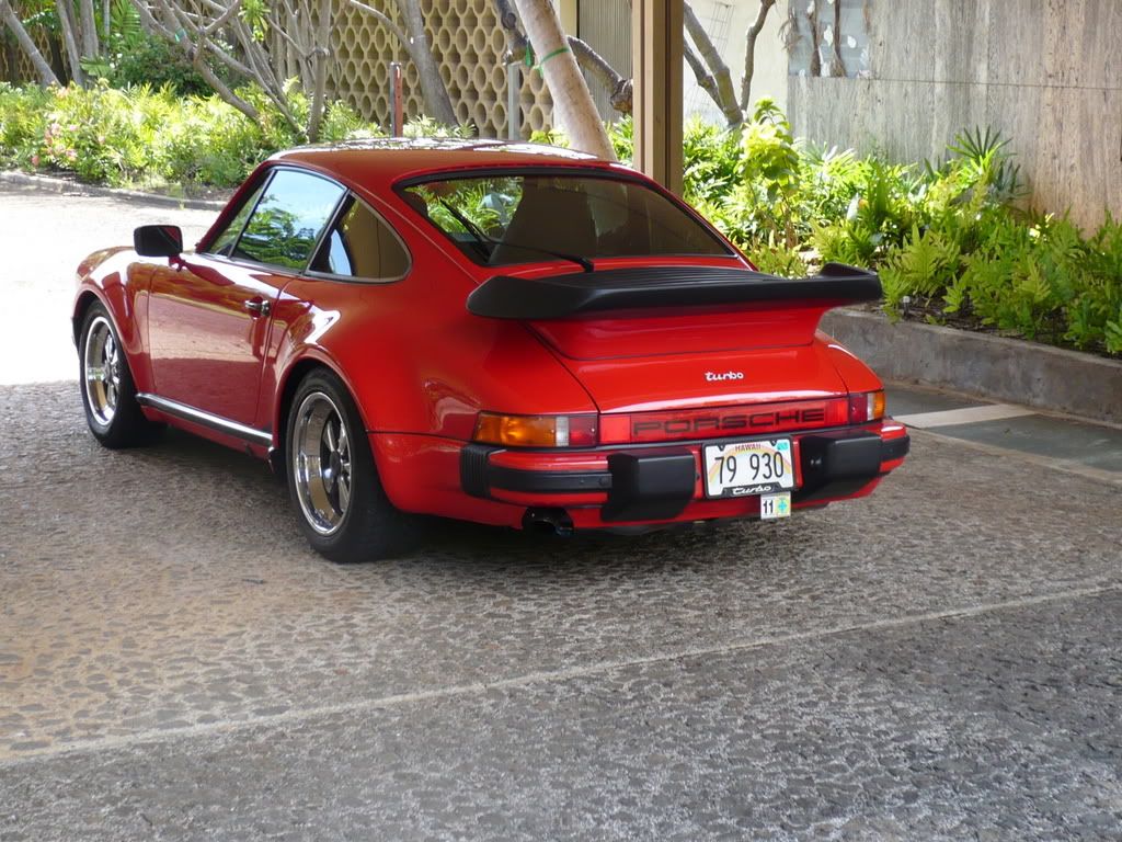

It's really hard to tell if those are 8s or 9s in the rear as they look alike. Here's my car with 245s on 9s and stock rear spacers. It's hard to tell, but I think that car is running 9s. One reason for the 225s is 245 tires are getting hard to find. That is why lots of people have moved up to 17" or 18", along with aesthetics.

For what it's worth, the car should have 28mm spacers on the rear. 9" wheels are easy to spot, as the lug nuts are recessed into the wheel about a half inch. Can't tell from the photos you posted exactly what's on there.
JR
Old 06-03-2008, 08:02 AM
Join Date: Jul 2006
Location: S. Florida
Posts: 7,289
930's came with 28mm spacers on the rear. I just measured that.
You can use 21mm spacers if you want to move the wheels inboard a little bit.
There's lots of room for wider wheels and tires in the back.
I think the 21's were on the rear of some 944's, and possibly on the fronts of very early 930's which had different hubs and rotors than the mid 80's cars..
