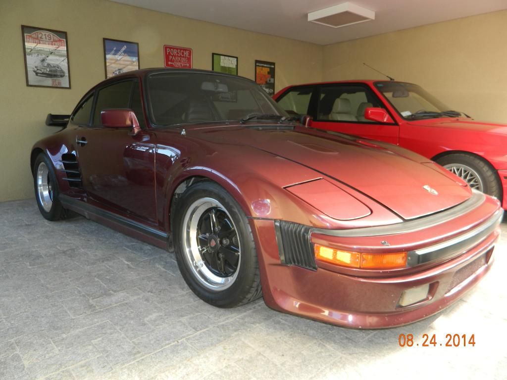

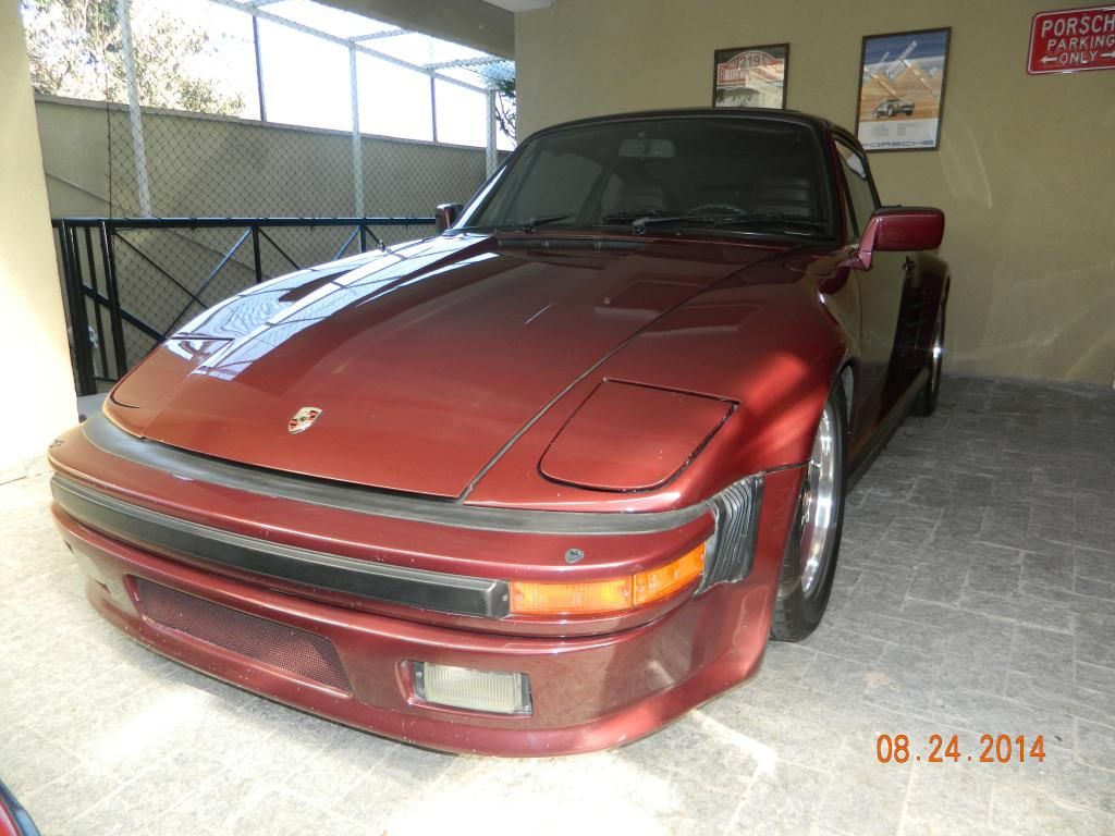

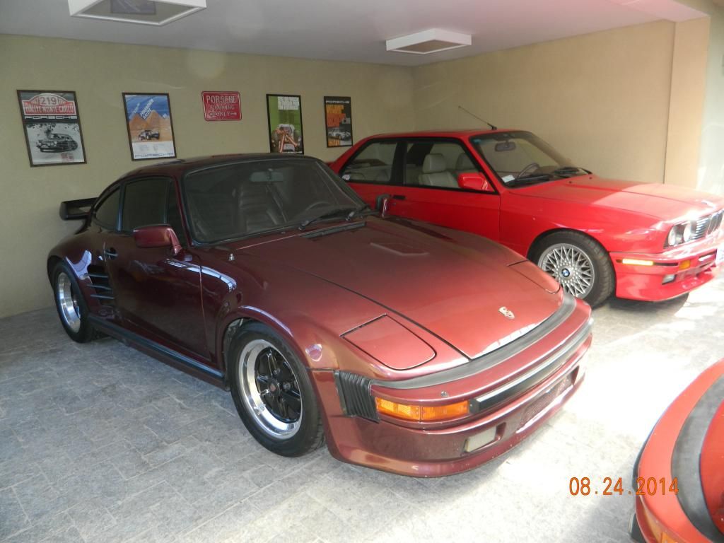

As always, great information. Please find below some pictures of the documented Factory Slantnose I purchased a few months ago:
Regards,
Slfan
