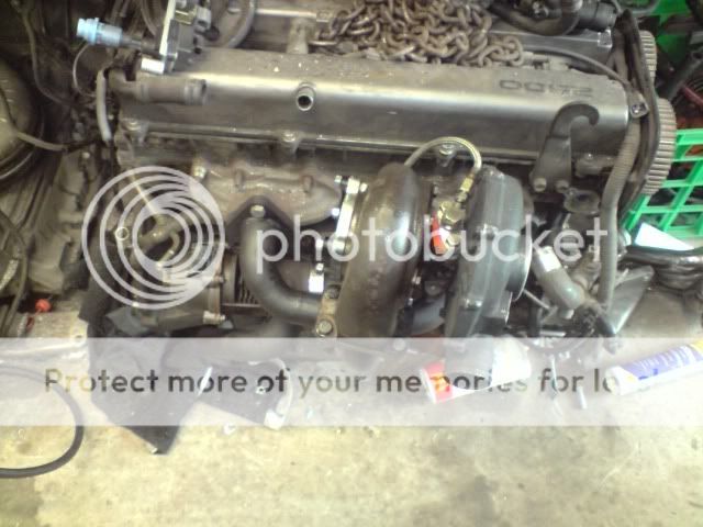

Hello and happy new year to everyone!
I own a very nice 83' 930 (euro spec). It has a nice SS sport exhaust and a 1bar WG spring.
I have purchased a second hand Kokeln that I plan to fit soon (I need the installation kit that I will order possibly today...).
I have the opporutunity to buy the following parts:
KUND-NR 930.123.013.04
GROSSE K27 - 3072 GD 11.11
ALT-NR 90 070 04 80
AUSF-NR 5327 970 7200
1. I am not sure exactly what I get... Could someone help me identify the parts?
2. Is it a bolt on?
3. The price quoted by the seller is 1000 for everything. Is it a decent price?
Thanks a lot for your help
Mathieu

Mathieu,
I have just been through this process with a K27-7200 turbo replacing the original 3LDZ turbo on my '86 930.
It isn't a direct bolt-on conversion because ...
  • the exhaust housing is at least 10mm wider than standard, (see pics) therefore your muffler will have to move to the right (this is OK if you have the space - I didn't so I had to shorten the pipe between turbo and muffler)
  • because exhaust housing is bigger, the turbo mounting bracket must be modified by cutting and welding
  • the compressor outlet pipe is different (3LDZ is a O-ring/sleeve connection but K27 is a hose and clamp connection)
The K27 compressor inlet and oil pipes are the same size and location.
The K27 compressor outlet pipe also comes up through the sheetmetal in the same location.
You will need to make up a new pipe between the K27 and the Kokeln IC anyway so be prepared to stuff around with various clamps, reducers and silicon hoses to make it work.
There are different ways to tackle the mounting bracket modifications (a search will give you some ideas) but I just moved mine sideways to the right about 15mm and deleted the top LH mounting bolt.
I can't help as far as identifying the part, but I suspect it is off a later model 930.
I bought a serviceable unit off eBay for $450 so EUR1000 seems a bit high. Then again, a new one is more than that!
I hope this helps. The pictures below should give you some idea what to expect.
Bill.

Billjam: thank you very much for the insight, I can now anticipate the level of work involved in this kind of upgrade

Bill, I just noticed that the plate on your K27 has the exact same numbers as the ones I was given (see my first post). So, assuming RarlyL8 is right you have a K27-11/11 and not a K27-7200!

The data plate pictured is for a K-27 7200. If you look at the first bottom line on the data plate, you will see it is a 7200. I believe a 11.11 is a 7200.

The K27-7200 11/11 is the "old style" 7200 as commonly seen on the C2T. It is a bit confusing. The "new" 7200 has vastly different characteristics and shares the same platform as the K27S.
The 7200 11/11 is not a bad turbo but there are improved modern versions. I use the 11/11 on my engine to test exhaust systems. It is very predictable and will not incourage over-boosting.
The 7006 is a large unit that was used in some Werks cars and 3.6 C2T's. Big turbo that pulls hard on the top end.
The most economic is the modern K27-7200 and K27S. They are also my personal favorite for street cars with few mods and stock heads. For a few hundred more the HF and HFS will pull harder through redline resulting in more HP. Check out my website if you like for more info.
