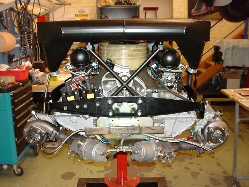

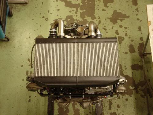

purplehaze 02-26-2009 09:48 AM
Damn, Tony, that's VERY clever.
Many thanks for posting!
I don't have the 3.8 tail with the openings, but plan to route the turbo intakes up for cooler air. I just didn't like the idea of flexy hose expanding and contracting each time.

JBL930 02-27-2009 09:45 AM
Originally Posted by VZ935 (Post 4509141)
There is actually an aluminum piece that fits on top of the IC and mates up the the upening that looks like a huge NACA duct in the roof overlay/rear window... then vents out the bottom of the rear deck. The air basically gets pulled right though .
http://img.photobucket.com/albums/v6...h_DSC04753.jpg
http://img.photobucket.com/albums/v6...h_DSC04755.jpg
http://img.photobucket.com/albums/v6...h_1f568fdf.jpg
I see. I thought for a minute (from the rear view) it was like this
http://i139.photobucket.com/albums/q...fancooler2.jpg
http://i139.photobucket.com/albums/q...FanCooler3.jpg
http://i139.photobucket.com/albums/q...tFanCooler.jpg
VZ935 02-27-2009 10:15 AM
No that is a real 935 and a Andial customer motor from back in the day . They would never put the IC right over the top of the flat fan . Most of the engines had the IC toward the front of the car like in my K3 935 . (excuse the adj Motons... so what , I cheated)
http://img.photobucket.com/albums/v6...h_DSC00117.jpg
A few were like my car including the Wayne Baker 934/935 that won the chapionship in 1983. Wayne explains this cofiguration here . He was running a single in GTO
http://www.waynebakerracing.com/images/934Champion/a_934_Champion.htm
Beautiful motor !
