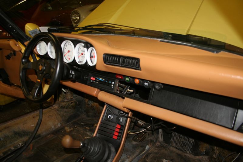

That car has been showing up on Craigslist for a while now. It looks like it can use some TLC, and you're going to be giving it. From the pictures I noticed rust on some of the intake components of the engine, which is sign that the car spent a good deal of time outside.
Does the boost gauge work? I looks pegged to the right in the photo of the dash...that's not where they normally sit. You asked about detonation. The sound you described could be detonation. Verify that you are not overboosting. Factory setting on that car was 0.8 bar, and going over that is not recommended, especially without an intercooler. Verify timing is set correctly, and if you can, check the AFRs on boost to make sure your mixture is not too lean.

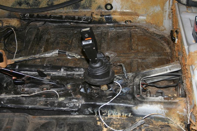

It seems that there is a problem that I am being told is normal for 930's. In the rear cross member that the rear struts go on to start to separate at the weld point. Well it has started in my car, so Mike at Mtech has a bracket that he makes and will weld the area that is separating and then weld a bracket on. Since the engine and trans are out. Its an easy job.
Great news is not rust what so ever. Rockers all look great. Floor boards inside and out great. Trunk, great. It has electrical problems. The two lights, oil pressure and alt light don't work. I have to find out why. No radio. Or wires. They had this big ass unit that took up the back seat. I ripped it out. It will be going up on ebay along with the seats.

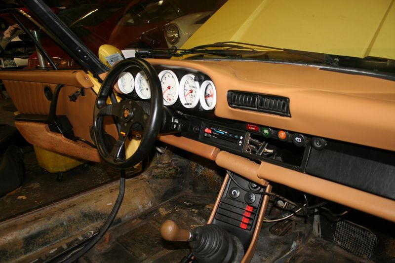

I got two seats that match the interior in almost new condition. I was very lucky. Again Mike at Mtech in New Rochelle had them in stock. Great price.
So today I ripped out the interior. Man that was fun. Cleaned it all up. In a few days I will be putting in a sound system and then putting the new rugs. I ordered Charcoal gray RSR rugs. I want a two tone tan/black like the dash, inside the car.

Old 08-19-2009, 05:29 PM
Join Date: Mar 2009
Location: New Windsor NY
Posts: 297
Pics
Here are some pics. The stuff on the inside is not rust. It is the bottom of the carpet and glue.

Old 08-19-2009, 05:56 PM
Join Date: Mar 2009
Posts: 297
More
More pics
Old 08-19-2009, 05:59 PM
Join Date: Mar 2009
Posts: 297
more

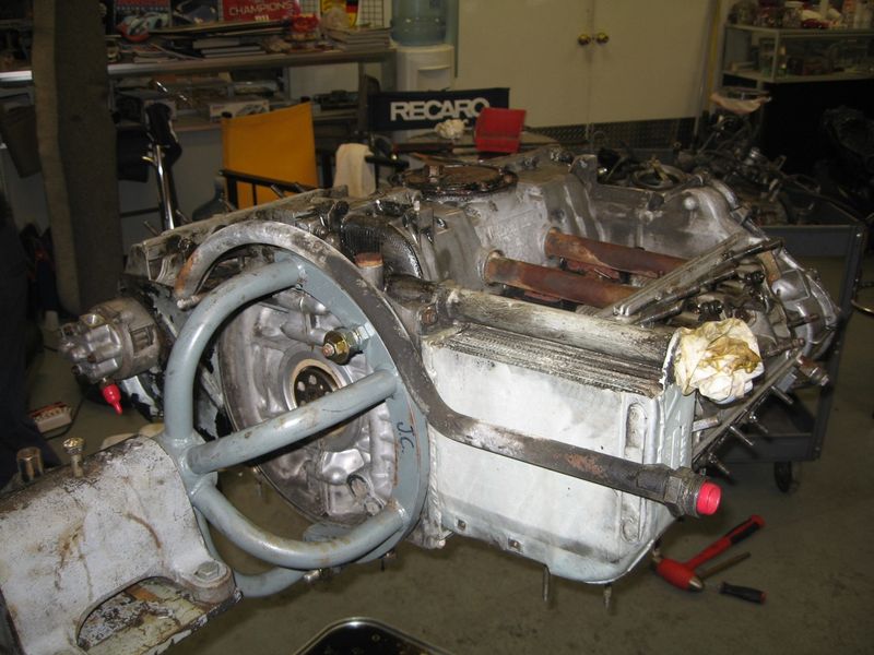

Broken Head Studs
Well the job just got a lot more expensive. Me and the mechanic who's name is Mike. Started on the engine yesterday. I had got an intake off of a 930 3.3 and a stock intercooler along with the throttle body. While stripping the engine apart to do the work, Mike thought, lets do the valves while its out of the car.
He open the first set of intake valves and (5) of the head studs were broken. Just laying there. 4 came right out. The other one is stuck all the way at the end. Its moving freely but the rocker is blocking it from coming out.
The exhaust side was fine. The other side, only one was broken.
Now from everything I have seen and read....I should have had a massive oil leak. This car did not have one. Before I brought the car, I was under it. It had seepage but not soaked with oil.
The other thing is that on the test drive. Which was about an 1/2 hr long. I drove it hard, soft, and through all gears. No problems. Didn't feel any exhaust leaks. Or lost of compression.
Even the next day when I drove it down to the shop, which is about 70 miles away. Car drove strong. At idle the valves were not tapping like crazy.
Anyway. So now the engine is getting a full top end rebuilt. So needless to say the car should be great now. LOL.
I brought this car as a project car so I have no complaints. The car WILL be a great 930.
Oh I also got the full carpet kit this week. The interior is all back from the reupholster company. Man do the seats look great. I can't wait for this car to get done.
I have a question. I do have the K27. I think that due to the fact that the 3.0 was non intercooled, the head studs snapped due to the pressure of the larger turbo. What do you think.
Right now I will have the stock intercooler running. Can't really buy another one right now. But I will when the cash starts to build up again. I'm in about $10,000 in the stuff I did already so I have to wait for a while.
I will be posting pics of the engine brake down later today.
That goes to show you that people can just make up receipts. There is no way this engine was rebuilt 10 years ago and sat. One thing I did see is that some of the head bolts were already changed. Those that it was changed to seems to be the ones that are snapped. Most of them that is. At least I know who redid the transmission so I KNOW that was done. They are a friend of Mike and they said that the car did not have a LSD when they got it and that they changed all the sycros and a new clutch.

Old 08-30-2009, 06:43 AM
Join Date: Mar 2009
Posts: 297
pics
Here are some pics.

I doubt that studs snapped because of larger turbo. As long as you don't overboost, larger turbo is gentler then small one as it doesn't produce as much heat.
Have you checked piston rings? Any in pieces?
