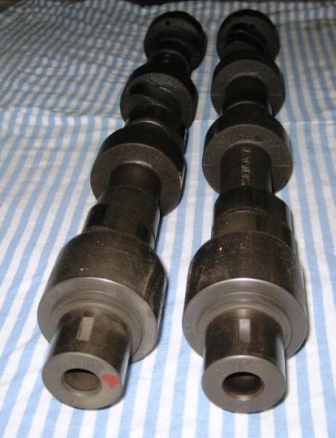

Hi all
I am looking for cams for my 930 for a future rebuilt . I found late Bolt on Type sc cams will they work on a 930. I will not put back the smog stuff will I still need to
modify them to work? If so how?
Thanks again and again

Been there, done that.

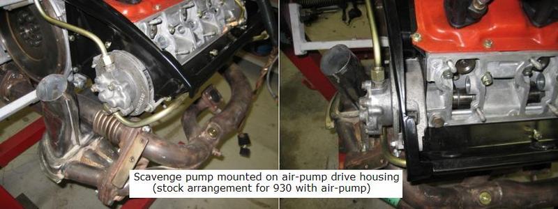

SC cams will fit straight in without any major mods if you delete the air pump and its drive.
I took lots of photos of how I did it so I'll post them below.
There are no problems with piston to valve clearance and, depending upon other mods, off-boost power is much better and power curve is much broader.
One thing to keep in mind is that the camshaft still needs to drive the turbo scavenge pump. The SC cams usually have two 5mm holes in the end so you will need to fit two roll pins to drive the pump. In a standard car, the heads of the two air pump pulley bolts normally drive the pump.
There are also some minor mods required to sheetmetal and piping. The inlet pipe to the pump needs to be shortened about 30mm and the sheetmetal needs to be notched to clear the outlet pipe. See pics.

By "bolt on", I presume the seller is referring to the two methods of securing the camshaft drive sprocket.
Later models have a bolt which screws into the end of the camshaft.
I think the early cams used a large nut which screwed onto the end of the camshaft. Don't know when this change occurred but I guess it must have been just before or during the SC models.
The cams you need should look like this at the sprocket end.
Bill

Mine looks a bit different:

So I need the bolt type? For the 930
Yes.

Originally Posted by billjam View Post
This one the right side is the right one. You have to make a spacer, because the shaft of pump is a bit too long. Just take measurements from surface at cam housing to camshaft vs. pumpshaft to pump surface, add 1mm for clearance, there you got thickness of spacer. I made mine as big that it closes whole in sheet metal too.
Roland,
It looks like the standard housing for the air pump drive pulley has been replaced by a plain machined spacer on your engine. You would need to do this if you deleted the air pump drive but are still using turbo camshafts (which still have the drive boss for the air pump pulley).
See first picture above for difference between 930 and SC cams.

Bill
You're right, with 930 cams you need a spacer, as thick as housing before.
I have 964 cams, they have the same layout as SC cams. So I needed a thin spacer, maybe 3mm (can't remember exactly). I think with SC cams you'll need a spacer too, in cause of the length of the pump shaft as I wrote above
Bill
Correct.
When I fitted my cams, I found the pump shaft was only about 1mm too long so I ground 2mm off the end of the shaft to give me 1mm clearance.
The potential interference between end of pump shaft and end of camshaft is an important point to watch for when bolting up the scavenge pump.
Bill

Posts: 7,208
You don't have to use the bolt type cams on a 930 or any other 911 motor, just get the 46mm nut and fat wavy washer that goes under it and use those instead of the 19mm bolt and washer that goes under it on the '81 and later cams.
