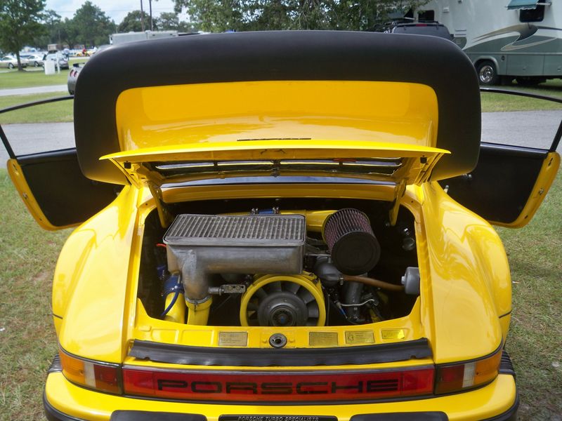

I currently have a CIS 3.6L 930 motor, twin plugs, ported & polished heads, group B cams, Carrera 3.2 intake, K-27 7006, equal length long tube/stepped headers, an Evolution recirclulating BOV, and a Garretson IC. I have a custom made full bay IC that I want to install, but my mechanic has been steering me away from having it done. I trust his judgement, he has a mechanical engineering background, and builds/repairs twin turbo airplane engines for a living. Also he has owned several 930's and been working on Porsches for many years on the side. I would like to know some of your opinions (pros/cons) on the swap. The only thing I could imagine on the negative side would be a little bit of lag. The turbo begins to spool @ +/- 2500, and on full boost @ around +/- 3200. I have added some pics of my set up, and the full bay IC I wish to install. Please let me know your opinions.

I've never heard of anyone with a 3.2 manifold and still on CIS, i've also never heard of anyone with 3.6ltrs and still on CIS! Tell us more about the engine, what compression ratio are you running, and at what boost level? What power are you making, and what have you done to get decent control of your fuel. Car looks great in yellow BTW

Keep the Garretson!! From what I can see the Garretson should flow more air and looks 10 times better.
Take a look at the airchannels on the "full-bay" IC they are tiny!

From what I remeber he just said that the Garretson was the most efficent, though he has not seen the other IC.
I bought the car 2.5 yrs ago, and the details I have given are the ones I know.
I don't know all the particulars about the compression ratio, I am currently running .8 bar, but would like to go to 1 bar, I was told by former owner its +/- 456 bhp. It has an old Haltech F3 ecu that needds to be tuned (can't find a com cable that plugs into that ecu), so the car runs very rich. I am about to update the ecu just get some tunability.
It's just that I've seen many high HP 930's that have a full bay IC, why wouldn't it be good for mine.

In this case the Garretson IS more efficient.. Guaranteed!
The outer dimensions I would think are about the same. Garretson twice as thick, full-bay twice as wide.
BUT, the airchannels on the Garretson is at least double the size of the full-bay, that makes it much better..

I still think that bigger intercooler might be better, you can have larger bore inlet and outlets fabbed up if necessary, a bigger surface area for cooling will be a benifit IMO. I obviously have no idea how good the cores are though?

On the full bay IC the top pipe is 3" and the down pipe to the turbo is 2" if that helps with any input.

By 3.6L CIS motor I think you are indicating either a 3.6L C2T engine or a 3.3L CIS 930 engine that has been enlarged to 3.6L, as apposed to a 3.6L EFI 964 based engine.
Either way the engine is now EFI.
I saw that intercooler for sale a bit ago and passed as it looks on the crude side. You own it so give it a try as it is reversible if it doesn't work well.

To install it would require some reworking of the piping going to my air cleaner, as it runs behind the garretson currently. and maybe some other adjustments.
