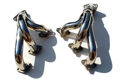

Zeb,
These make me lust!
Originally Posted by zeb930 (Post 5122707)
DonE 01-12-2010 06:44 PM
Finally, some real turbo headers - short, straight and right to the point. Those are worth building a car around....
Thanks for the pic.
930gt-40r 01-12-2010 07:00 PM
And the best part is that they are simple- I could likely fabricate a set of the 935 headers...
DonE 01-12-2010 08:20 PM
That's exactly what I'm thinking. No fancy jigs or fixtures to fool with - just straight pipes right to the back....think dual zork...
I bet I could "stitch" weld using SS wire in my MIG. Only an experienced eye could spot the difference, but since its under the car, who cares.
930gt-40r 01-12-2010 11:34 PM
When I twin my car someday this is the system that I will use.
JBL930 01-12-2010 11:59 PM
Not as short and to the point as 993tt headers though! Bigger bore no doubt, also has exit for external wastegate, but surely if short and simple is the goal then 993tt size/style ones are going to be the best? Also almost equal length

Speaking only of well designed short and equal length system for a 930:
An equal length is 'probably' going to make another 20-30hp in the mid to high range than a shorty.
A shorty is 'probably' going to come on boost about 100 to 300 or so rpm faster than an equal length.
Both will probably come in faster and make more Hp than a stock late 930 HE/header system.
The factory stock late 930 headers are probably less prone to failure and have the best ability to deliver heat.
There are extreme Porsche Turbo builders that are using shorty's and equal length headers to make up into the 700fwhp and higher range.
There are 930 turbo motors running stock late 930 headers making over 500fwhp. (Monster CIS claims over 600hp on stock headers.)
Then there is proper sizing of the primary tubes that can reduce lag or support higher HP or turn a well designed system in to a poor performing if not matched to the motor.
There is no perfect system for all situations and builds.
If we are lucky we have good information to base decisions on and different systems from which to make choices.

1100sport 01-13-2010 01:31 PM
The 3.2 is not the right "environment" to draw conclusion on the advantages of equal length design Vs non equal length design at least if you use SSI for the demonstration. This is because SSI are 35mm inside diameter primaries whereas on the Carrera 3.2l Porsche has enlarged the OEM system to 38mm inside diameter primaries. Still the SSI manage to outperform the OEM system in mid range, but are too restrictive at higher revs. If you take an equal length design with the same diameter as OEM on a 3.2 (B&B for example), you will notice an improvement everywhere, and more than 10hp increase at peak power.
On the 930, the OEM headers are still 35mm inside diameter. You will notice an improvement off boost with a "SSI like" system. But on a turbocharged engine, power comes with boost - and nothing beats short headers when building boost is what matters. Still, for a street application, a SSI like design header is very nice on a 930.
