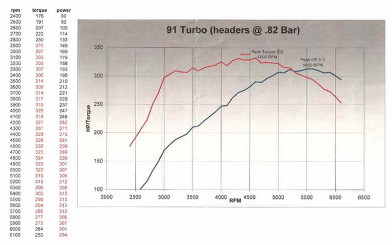

Here's some (older) dyno data from my 91 Turbo. These are wheel hp numbers run on a dynojet as I recall. Since this run I replaced my B&B muffler with a custom Borla XR-1. For reference I will see ~14 psi at ~2500 rpm so the numbers would be a bit better then below....

Jeff, Stock cams & Turbo?
Sounds like close to the same muffler build I ran on my C2T.
Ya...everything is stock except the exhaust.
