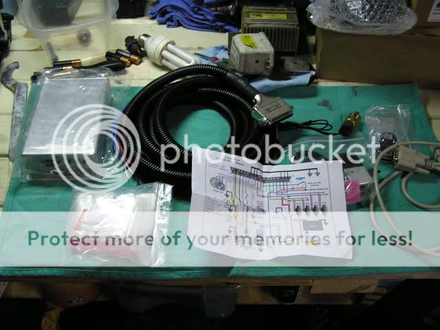

The beginning of the conversion to EFI and EDIS
I along with some friends pulled the motor today to do some top end work and convert to EFI and EDIS.
Here is the plan. After sorting out a few issues going on with the top end the CIS will go away and an EFI system will be installed utilizing MS2 along with an EDIS. If time and budget permit the turbo will be replaced with a K27s with dual wg's and Ben's Y-pipe.
Also some other goodies will be added which will be revealed later.
The goal is to have a motor that is powerful, managable, and reliable in the 400hp range to the wheels. The car's will be used for a combination of street and track use. I'm keeping all of the creature comforts like stereo, a/c, heat, power windows, etc.
Here's where I ended up tonight after about an hour's worth of stripping parts.

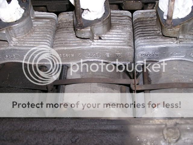

turbo and exhaust off
I got the turbo and exhaust off earlier this morning. It sure it tight in there even out of the car.
Note: none of the support brackets for the cam oil lines are attached. Nice... this would have been problematic later. Also note that is was is issue getting access to the distributor hold down nut with the way it was clocked. There are just so many little things that I see that are just careless and I'm a Newbie to this. Some of this was done at your "neighborhood" garage that has no "bizness" messing with this car. Almost like me, but I own it...

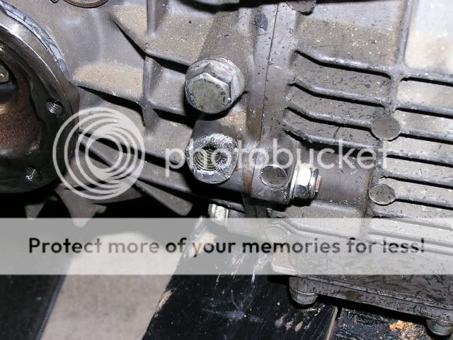

I got a little more taken off. What a mess. The build up was almost a 1/2" thick on some of the ducting. Note the broken head stud on 5 and the what would apppear to be a new headstud on 5 also. Given all the grease and stuff it's "shiny" like new. Is that the famously expensive 993 head stud?
Found some wiring issues too.
Found this also when we pulled the motor. We think we can fix this without too much drama. I found a bolt on the ground with a crush washer. Now I know where it came out of. The metal was fresh and it had what appeared to be bathroom silicone on the area. My guess is a shop was just trying to get this out the door then the tranny was reinstalled after a rebuild... Oh well...

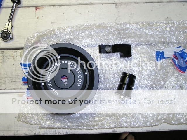

Just an update. I haven't had much time in the last few days to do much with the motor, but I have started to get parts in for the EFI and EDIS build.
Crank trigger wheel, VR mount,and Dist plug. (btw-why is the distrbutor called a "dizzy"?)

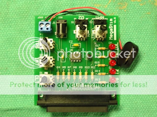

Also from DIY a stimulator board. Neat little thing.
and the MSII 2.2 with ms3 adaptability.
Waiting on gaskets and misc parts from EBS. btw Troy is great to deal with there, thanks Troy! Also waiting on the EDIS kit from Ebay. Which btw, is so much easier than going to the terribly muddy junk yard (like walking through oatmeal) to get.
Gonna put the engine up on a stand tonight and may just do a leak down on it for curiousity's sake if we have time before I tear into this weekend.

I was going to ask if a) you had a done a leak test, or b) whether you were going to split the case - then I read your last post
I have a K27-7200-S, just wondering if it will be big enough for you (considering all the EFI trouble you're going to) - you could drop some monster on there!
