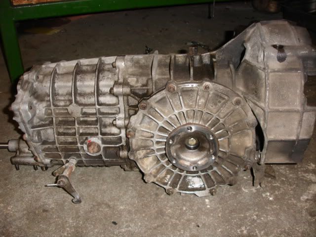

Hello,
how can we identify a G50/50 for sure from outside?
..often the numbers on the bottom plate are invisible
further, is there a difference from outside to a G50/00?
Anyone know the latest prices for a G50/50 with LSD?
thanks
Falk
87 930 bblk/blk
88 3.6 white/blk

...is this a G50/50?
thanks

Hi Falk,
To me it does not look like a G50/50, more like a G50/03, G50/04, G50/05

...maybe this helps to identify this gearbox?
Falk

that is just a part number for the housing.
you should find the number to identify the tranny under the transmission.
You do not have a g50/50.
It can be a g50/52 or a G50/03, G50/04, G50/05. It will say under the tranny if it's not grinded away...

Yes,
I already found that this is G50/52.
As I have a 87 930 with G50/00 conversion,
this G50/52 will not fit easy.
Further, I havn`t bought this gearbox yet,
for me it seems less worth then a G50/50,
is that correct?
Anyone know what is involved to swap a G50/00 for a G50/52?

The 50/52 is the stock 964 turbo box, and obviously easier to come by.
You can tell by counting the bolts around the side cover, the 50/50 and 50/52 have 12 bolts, i think the lower "none turbo" G50's only have 11. I didn't think there was any real difference between the 50/50 and 50/52, but i have heard somewhere that the 50/50 was stonger, but not sure. Either are great boxes!!

The g50/52 has a bigger differential. the differential housing is aprox 2.3cm longer than g50/01.
Also i think the trannsmissions that have dual mass flywheel has 2mm longer clutch housing.
You ca see my g50/01 to g50/52 swap here: Converting long G50 into short g50
If you already have a g50 I don't se the need for a g50/52...

Stein,
I saw your conversion threat before, very infomative!
Another difference seems the front cover with the
different mounting points.
In Steins conversion the front cover was simply cutted
and if I am right, new mounting points welded on.
The G50/52 above has a LSD and is for sale+ ship
across Europe at ~2250,- Euro (3200$)
If I pass on this, I will let you know,
maybe one here needs it.

All G50/50's and G50/52 boxes came with LSD from the factory.
I don't agree that any G50 is as good, the gearing in the turbo boxes is better suited for the turbo, and they are stronger.
2250 euros is an absolute steel Falk, the kit car guys would pay double that figure. Other than it being a bit dirty, do you know if it's in good shape?
truly, only the seller states its in very good condition.
more, I guess its neccessary to open it to see the condition.
To bad it isn`t a G50/50 which I would like to have for the case
my G50/00 needs replacement.

This is always good info for a thread like this
G50.00 1987-1989** 3.2 Carrera, Rest of World version
G50.01 1987-1989** 3.2 Carrera, US/CDN/Aus/Jpn version
G50.02 1987-1989** 3.2 Carrera, Swiss version
G50.03 964 C2 1990-1992 1L is plain, 2L is M220
G50.04 964 C2 1990-1994 Swiss version
G50.05 964 C2 1992-1994 US/CDN version including RS America
G50.10 964 RS (street legal basic race car, non-US)
G50.20 993 C2 US/CDN/Swiss version
G50.21 993 C2 ROW
G50.31 993 C2 RS version ROW only
G50.32 993 C2 RS M003 (clubsport) version ROW only
G50.33 993 C2 RS Swiss version only
G50.50 3.3 Turbo 1989 first G50 turbo version (larger ring & pinion)
G50.52 965 C2 Turbo 1991-1994
Ratios
G50/00 3.5 2.059 1.409 1.074 0.861 (after 1988 0.868) diff 9:31
G50/01 3.5 2.059 1.409 1.125 0.889 (after 1988 0.892)
G50/02 3.154 1.895 1.333 1.036 0.861 (after 1988 0.868)
G50/03 3.5 2.059 1.407 1.086 0.868
G50/04 3.154 1.895 1.333 1.029 0.868
G50/05 3.5 2.059 1.407 1.086 0.868 diff 3.333:1
G50/10 3.154 1.895 1.407 1.086 0.868
G50/50 3.154 1.789 1.269 0.967 0.756
G50/52 3.154 1.789 1.269 0.967 0.756
