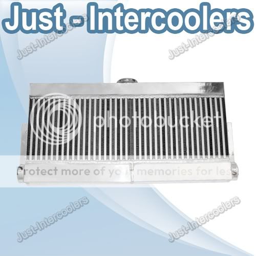

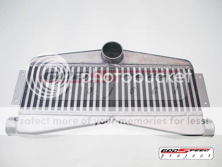

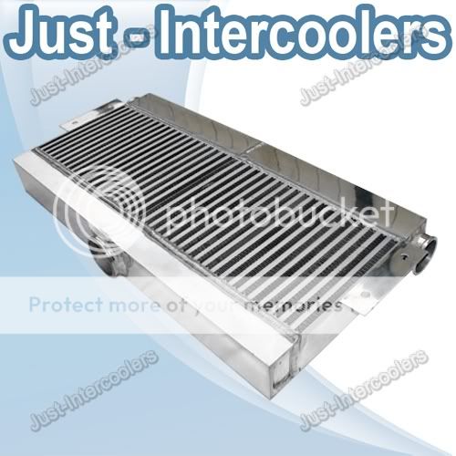

I have a 1985 Porsche 911 twin turbo and i have been thinking of replacing the intercooler
I found these two. How do you think they fit on a 1985 911?
One thing is that i would like to have the outlets to the turbos pointing down instead of to the sides
On th first one i would like to have the inlet pointing straight forward to the engine as well.
The first picture of the intercooler is upside down.
Measurements is 27"x13"x7"
Or this one. Measurements is 29"x13"x7"

As long as the inlets or the turbos were facing down you should be good.... But have others measure the width of there's to be certain you are not too wide.
I know nothing about the companies quality, flow rate, or efficiency either... Mybe someone else could help with that.

The 'Just Intercoolers' one has a lot more cores, and the fins 'look' tighter packed.... My money would be on that one having better cooling ability.
This thread is a good read 9M Prototype intercooler test report - Rennlist Discussion Forums Results on different coolers, and as you can see the better performing ones has more cores and really tightly packed fins. These are high end coolers, the best one being a Secan, i'd look to copy it as best as possible

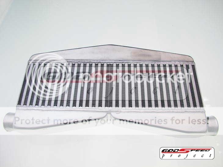

I suppose there is quite a difference but it would be fun to check out the cheap intercooler.
I can easy convert the intercooler so the outlets points down to the turbos
I suppose the to outlets goes to the turbos and the inlet to the engine
Have a look at the picture and tell me what you think. Note that the overall lenght will be shorter because the outlets to the turbos wil be on the underside.
I have tried to mark it with grey arrows
This is the info about the intercooler:
Length 29"
Length (Core) 24"
Height 13"
Height (Core) 7"
Thickness 3.5"
Inlet 2.5"
Outlet 3"
Compress Air Flow Rate <700Cubic Feet/Min, Rated to 600-700 Max HP
Working Pressure: 5~50PSI
Pressure Drop 1~4psi@35psi; 0.2~0.5psi@15psi
Hot Air Temperature 32F~302F (0C~150C)
Material 100% Aluminum
Design Bar and Plate
Construction Machine Cut and Stamped, Hand Welded
Finish Polished
Net Weight 22 lbs
Tell me what you think of the description of the intercooler
