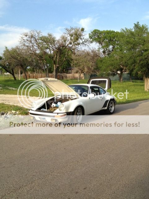

I've searched and trying to figure out:
What controls both fuel pumps and fails when the motor is hot?
Thermo switch?
I was stranded by the road today. It's not not the over boost relay, it's not the fp relays.
engine temp was about 190f and would start to sputter and not have any power. Both fuel pumps are running, but at some point they would both intermitently stop at the same time, the motor would stumble, and eventually the motor would shut down.
I saw some post by Jfairman that would indicate the WUR, but that was very recently rebuilt by Larry at CIS Flow tech and the fuel head was checked out.
What controls the fueul pump electricity.
The application is a 78 930 with SC cams and HF turbot with M&K exhaust. Otherwise stock.

On my first breakdown, did I mention there were two? Once in a parking lot, then about an hour later 5 miles down the side of the road. It appears to be heat related to some extent. All the relays were working, I changed out with known working relays. We are getting voltage to the rear pump (easiest to check), we bought a jack and I put a meter on it. All the fuses are good, did a visual inspection and took many out to phsically make sure they were intact. I think it is a switch of some sort that when it gets hot is interupts the current to the pumps.
Given the theory of heat being the catalyst for the event, we cooled down the motor with bags of ice.
After about 30 minutes it started and I drove it 5 more miles before the started to stumble and eventually fail again. At this point the car was not driveable adn I flatbedded it home.

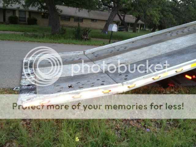

I replaced the switch and it started and ran. I drove it until it started "popping" like crazy and then stalled. This is becoming a common site. At least I was only about a 1/2m from the house.
I am also learning to appreciate the dual angle flat beds.
