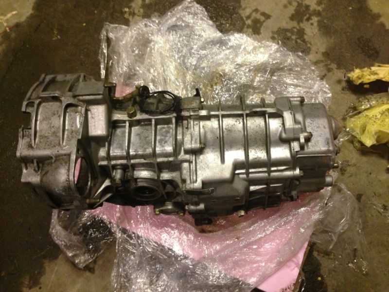

Well thought I would make a thread about my G50 conversion.
When I bought the car it had another R&P in the 930 transmission. As I thought the engine cruised a bit high on the highway, I replaced back to stock R&P last year.
After reading about some G50 conversion I decided to do one myself.
I was looking for a G50 with shorten bell-housing, but it was not easy to find at that time.
Bought a G50/00 of ebay in Germany.
Since I did not want to cut the torsion tube I needed to have the Bell-housing and main shaft shortened.
I found a mechanic in Norway that was familiar with the G50 transmission to do the machining for me.
This guy is really a turbo guy, so had to choose him for the job
He is having one of the worlds fastest bug at around 950 hp and uses G50 in his bug dragster.

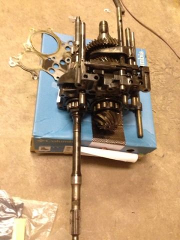

Then It was just to strip down the transmission, and then clean the housing before sending it away the to the machine shop.
The internals looked very nice with no noticeable wear.

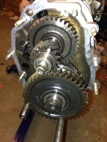

Started with removing the rear cover, 5'th gear and reverse.
Then I need to separate the main shaft.

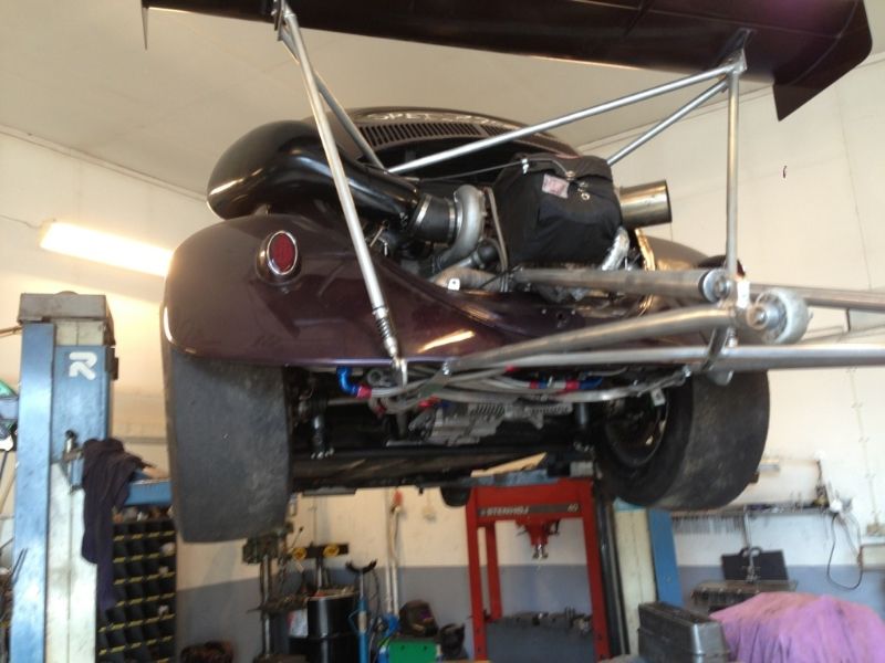

Delivered the bell-housing and main shaft before Easter and picked it up Friday.
Had to take a picture of his famous VW bug. This his record is in the area of 8.2xx something on the mile.

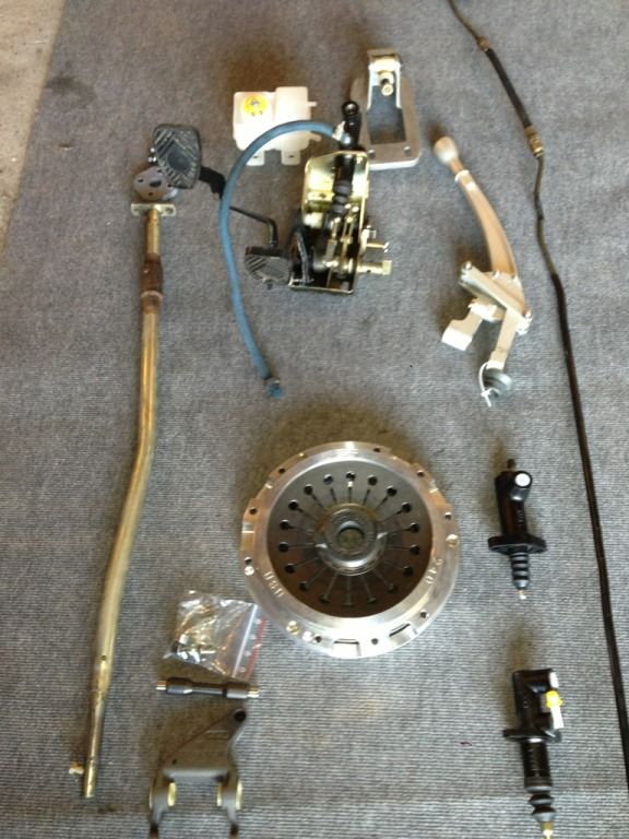

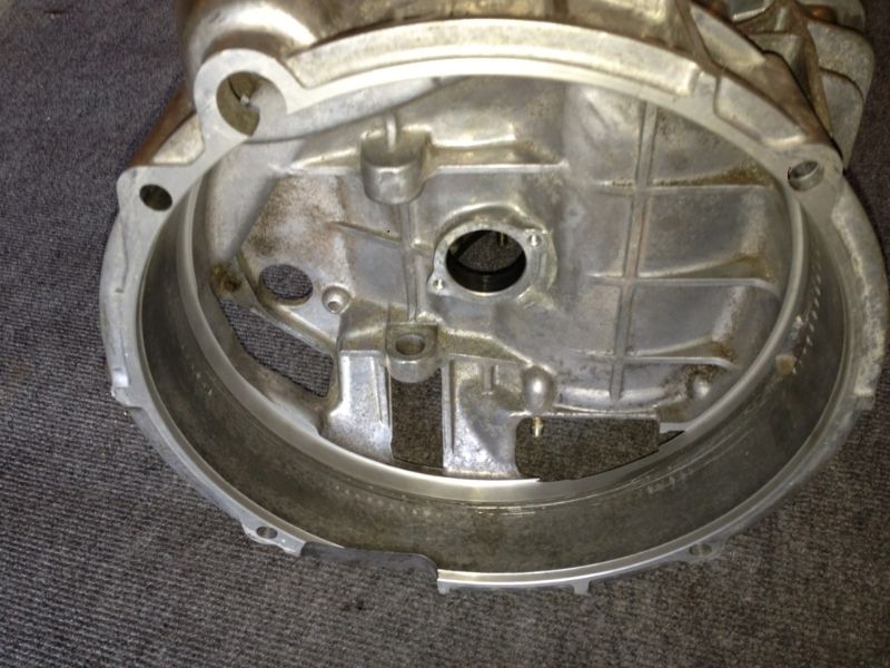

Here is what the short bell-housing looks like. The piece on the floor is what was machined off.
Some of the parts going in the conversion.
KEP stage 2 pressure plate with G50 diaphragm, CMS billet aluminum side cover, Carerra pedal assembly with slave cylinder, new master and slave cylinders, Wevo G50 short shift...

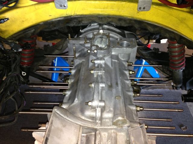

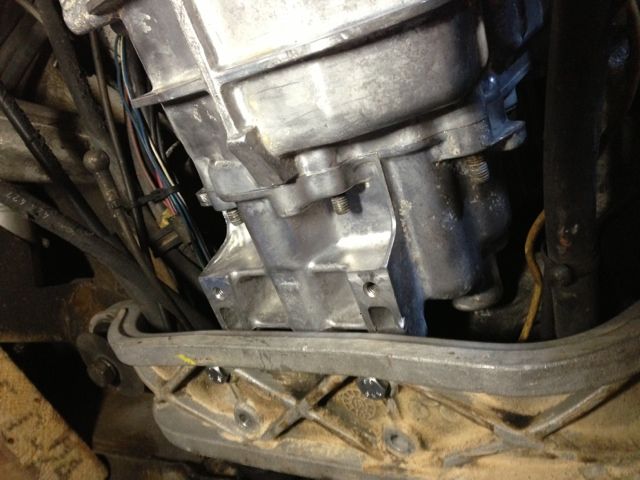

Was in the garage today to test fit the transmission. It was a good fit without any adjustment on the torsion tube.
I see many go for the weld on mounting kit and new transmission cross member.
I will keep the stock chassis mounts and just modify the cross member.
It fitted by moving the cross member a bit forward. Will have to weld a bit and make new holes and the original will fit

Posts: 939
29mm is the max you can take off the bellhousing.

What am I missing here? I am running a G50 in my project car. I notched the torsion tube to clear the trans and everything bolted up fine with the G50 cross-member. I haven't tried to bolt on my rear sway bar yet.
Link to page with torsion tube work...
