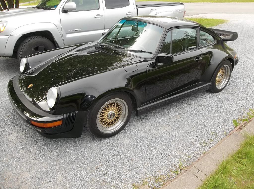

And a picture of her, 132 000KM on the clock.

Oh very nice! Some say different but I like the boxed rockers. Yes press down to engage and turn right to richen, I have an AFR gage myself and it's great so you know where you are.

Old 06-06-2013, 04:37 PM
Join Date: Jul 2003
Location: Back in B'ham, AL
Posts: 3,440
Prrrrreeettttycool!
Welcome!
