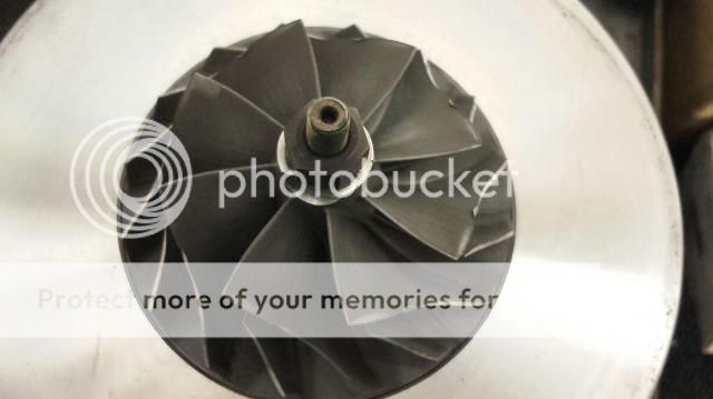

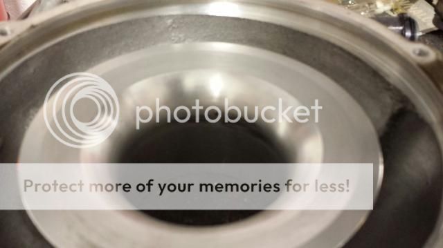

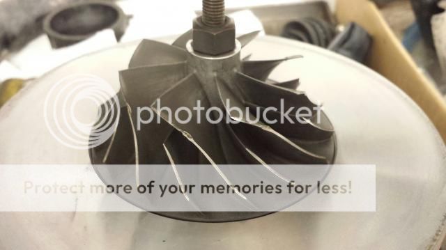

So I heard a noise upon turning off the motor on my 78 930 I didn't like. It was coming from the turbo. It sounded like the compressor wheel making slight contact. Upon inspection, it was quickly discovered a dial indicator nor feeler gauge was needed.
There was excessive radial play but the end play was not bad...all relative of course.
There was some contact made with the compressor wheel with the housing.
Options that I can see are the following:
  • Send to Durabilt for a rebuild
  • Order another K27 HFS
  • Move to a ball bearing turbo
  • use a leaf blower (I had to throw that in there)
I am not comfortable with a DIY rebuild here, not on this part. After tinkering with it for an hour. I think I will leave this to someone who does this all through the week and the year, etc.
Thoughts, other options I have not considered? Has anyone used Majestic in Waco, TX? They focus on Diesel stuff mostly, but turbos are turbos.

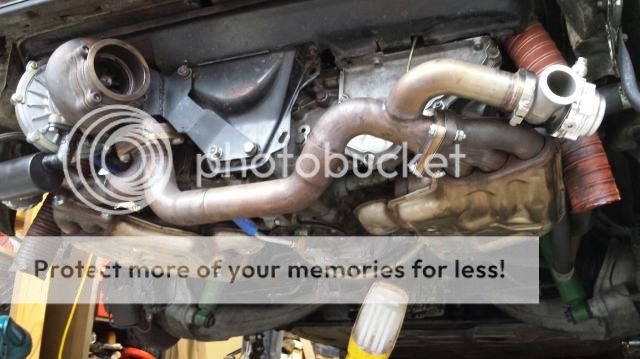

Heres a good shot of the GT35R
I purchased this from Chris @ TK, and would do it again if required. I'd go with this unit as it leaves room for the madness!

Philip,
Thanks for posting pics. I have ghl's also, but just had to tig them again to fix some more cracks in the collector. Have you had much problem with them? I have set of 993HE's that I have flipped the flanges so I am thinking about using that set up. No issue there with those collectors and they have great heat. There is a little drama with heat ducting, but not much. I saw you have twin wg's. Nice. What muffler are you running? Magnaflow from TK?
John

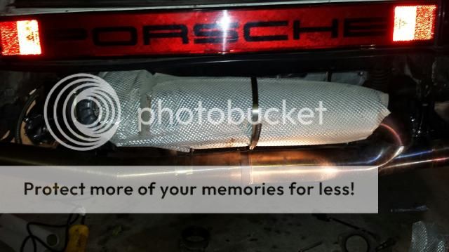

So it's on order, the new turbo that is. Hopefully I get time to install it before the Hill Country Rallye 2014 (Hill Country Rallye).
I am also changing my exhaust set up from ghl's and a Borla exhaust to 993 HE's with the flanges flipped, twin wg's (tial 38mm 1 bar), and M&K y pipe and dual exit muffler. I ordered a GT35R for my 930 that has sc cams but is still CIS.
This set up came off of my other turbo car while motor is getting rebuilt.
I also made a heat shield that was cheap ($15) from a turbo volvo. It's aluminum so it shouldn't damage anything should it rub. It should be effective. I made a hole later for the O2 sensor for the meter. Easy to work with, but use good leather gloves unless you like band-aids.
