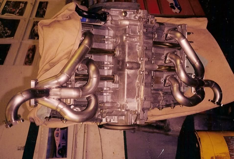

VZ935 06-23-2014 08:55 PM
I did the same thing with mine Mike. Might not be the best way but my car still ran pretty good.
Beautiful work by the way.
http://img.photobucket.com/albums/v6...enginemock.jpg
http://img.photobucket.com/albums/v6...0R/headers.jpg
Mike Billings 06-24-2014 06:07 AM
Van, I think your layout is the most efficient. Good primary length for a race car. Nice primary routing. Good wastegate setup. The weight of the turbos is moved forward in the chassis. Lots of space for things like exhaust and intake in the fender wells.
That layout likes the flat collectors as well!
Did you design that or do you have an expert?
VZ935 06-24-2014 06:20 AM
The owner of TiAL designed and built my exhaust, intercooler and turbos.
I had to modify the frame for clearance but we decided to make the run to the intercooler short and the headers as short as possible that's why the turbos are off to the side of the motor and we have these long pipes wrapping around to the back to exit
With the short bellhousing box moving the engine toward the front of the car by two inches all of that did help with the balance of the car.
