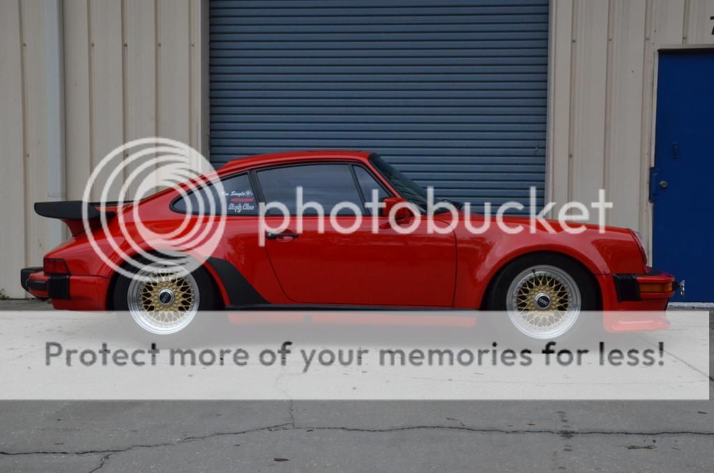

Ok i did it! the specs from wheel rim to top of fender were:
Front of car
Left 57.5cm 58.5cm Right
57cm 57cm
New specs:
55.5cm 55.5cm
57cm 57cm
i didnt touch the rear.
Result, much better than it was:
JUST barely enough to clear my driveway:
This was the Before:
The bump steer... i guess i feel something now but it was almost the same before. Also i kinda like it cause you feel more of the road?

So I finally got a minute while it was light out to take a couple pics of the car now that it is lowered. About 1.375 inches lower all around. Bringing it in Monday for new tires (2001 and 2005 date codes on the current tires), getting Bridgestone Potenze RE-11's in stock sizes. Also adjusting the fuel mixture so I actually pass inspection and an alignment all around.
Here is the view from wheel height of the gap between the wheels and the fenders (front first then rear):

My fronts are the same as yours, But I put bigger T-Bars and Von shocks in mine. No issues rubbing on the fronts. The rears were a different story. After the Pain of re-indexing the rears I just today installed the ER Adjustable spring plates. I brought the backs up to right around 25. The rears were at 24, and it was rubbing inside the tops of the flares bad under hard acceleration. Also be aware that at 24 rear, my camber was -2.5 to keep the toe in spec. It drove me nuts using only 80% of my tread on normal street driving. Hopefully I can get it to -1.5 or less now.
Here is the 24.5 / 24 look. no new pics of it at 25 rear (yet). But after the new alignment, I plan on getting spacers out back to fill up the gaps a little more.
