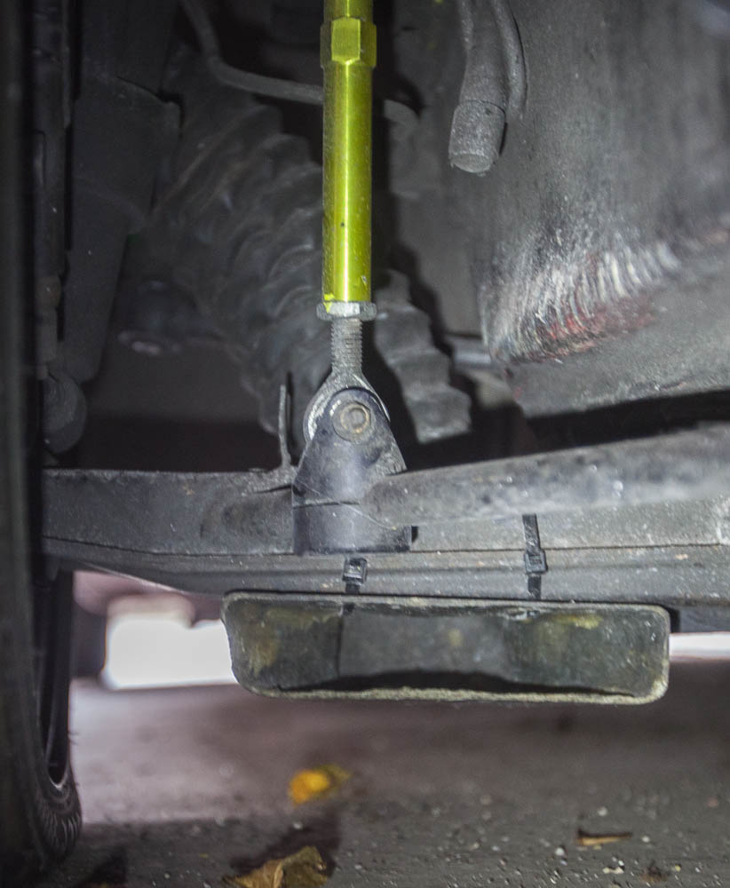

Well, I have the car, but the thing is so low to the ground, I can barely get pictures.

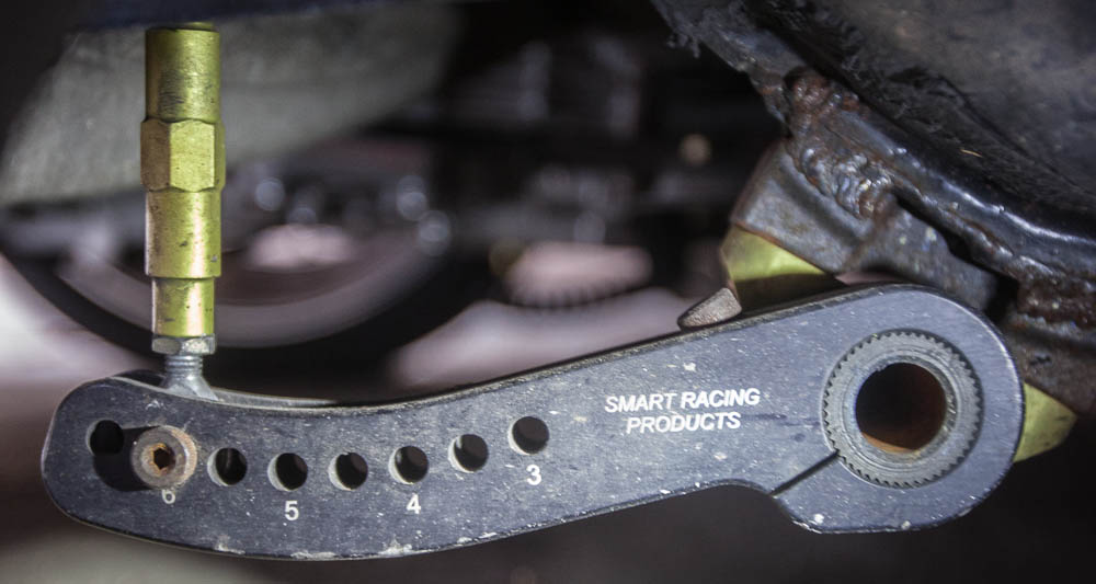

It seems I have a fully adjustable Smart Racing Products setup:
I'm guessing I can raise the car as per usual, then move the torsion/sway bars to a "softer" setting, and maybe get a street-friendly ride without replacing anything? Does this seem viable?
The car does not like bumps at this time. Camber is extreme, as well.

You should confirm what you have as far as torsion bars, sway bar diameter, and shocks. Smart Racing sway bars come in different diameters, so going to a smaller bar is one option. You may find someone on the board that will swap you. Depending on the shocks, you could have them re-valved to a softer setting, and go down in torsion bar dia.
Your almost at the softest setting for the rear sway bar based on the photo.

Aha, I was wondering if I was on the hard end or the soft end. The hard end must be great on tracks made of marble.

Your on the soft end of what ever bar diameter your running.
