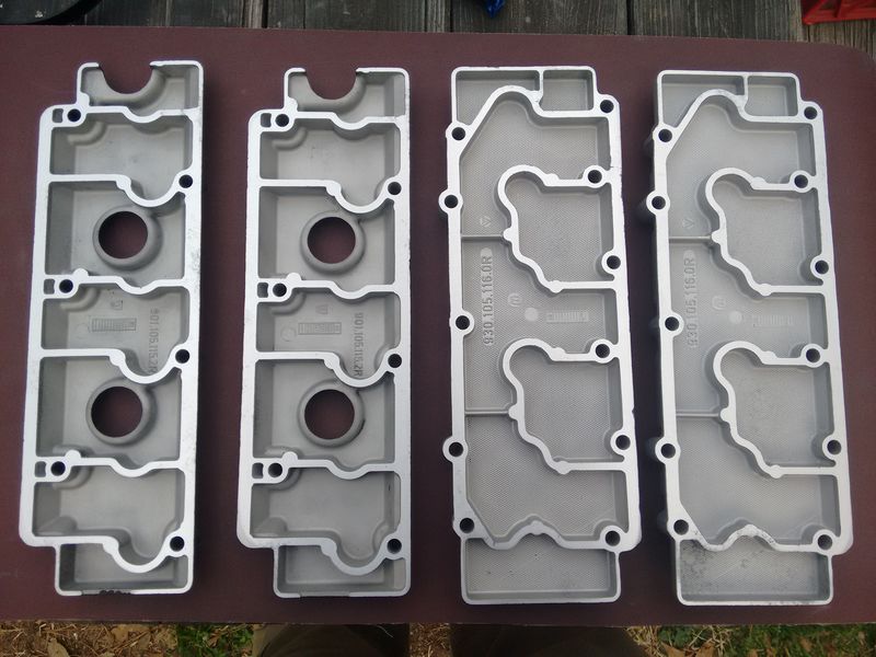

The valve covers and cam carriers had some pitting on the gasket surface. More than I thought would seal with new gaskets. So I pulled all the studs from the cam carriers. I ordered two 16*48 sanding belts. 220 and 320 grit. I have a piece of granite countertop about 16*35. So I cut open the 220 belt, layed it out on the slab of stone and proceeded to make the valve covers flat. Next up cam carriers.
My son helped hold the paper while I sanded.

Big deal that the gasket surface of the cam carrier needed to be touched up? Seemed like the best way to attack this problem. Some of old gasket had bonded onto the cam carrier and I didn't feel safe attacking this surface with a scraper. The remainder of the gasket sands right off. Easy, though it was time consuming. Bottom surface of cam carrier was fine so no dimensional change as far as the engine assembly stack up.

No the job is a big one. Looks like you did the right thing though.

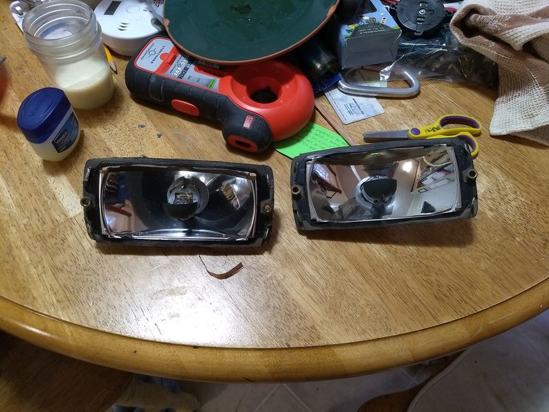

Ordered some new fog and tail light lenses, so I decided to take off the factory lenses and get a good look at what I had to start with. Passenger side was cracked, driver's side just pitted. I got them both off the car and cleaned up.

Both reflectors were dusty, but had zero corrosion. The gaskets feel like they are brand new, they must have a high % of natural rubber in them. Plastic housing seems to be made of glass reinforced nylon. They have faded a bit, but I have cleaned them up and will paint with satin black paint. Will look and perform better than new once I put in a relay kit.

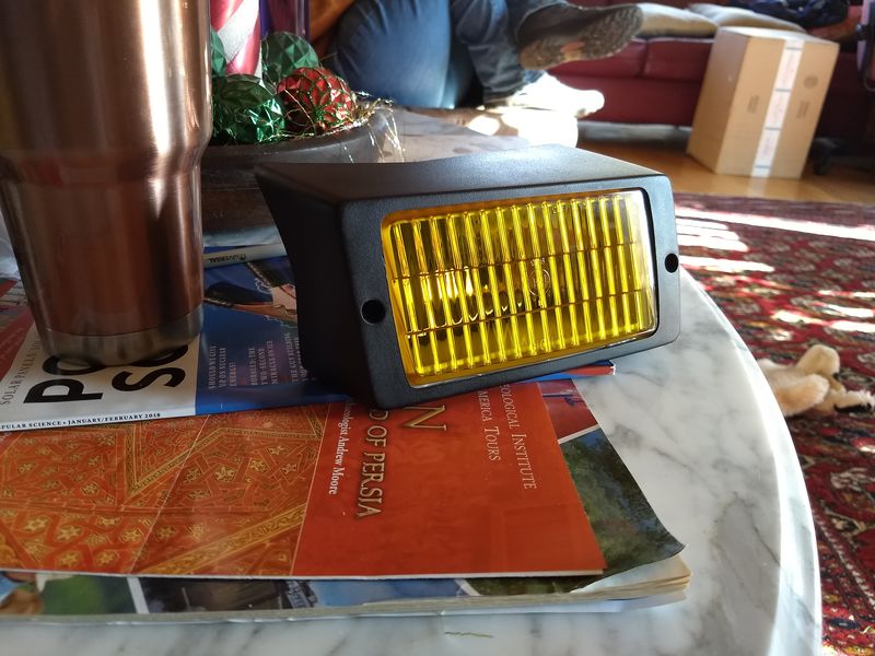

Spent the holiday with family and the fog lights. I cleaned the plastic outer housing very well, it is glass fibre reinforced nylon which takes paint quite well. After hand washing them a few times I ran them through the dishwasher on hi-temp sanitary cycle. Then I painted them with satin black Krylon Dual plastic paint. I got 2 good coats on them and they look like new. I decided to deviate from original and got yellow lens. They are aftermarket URO brand but look really good.
