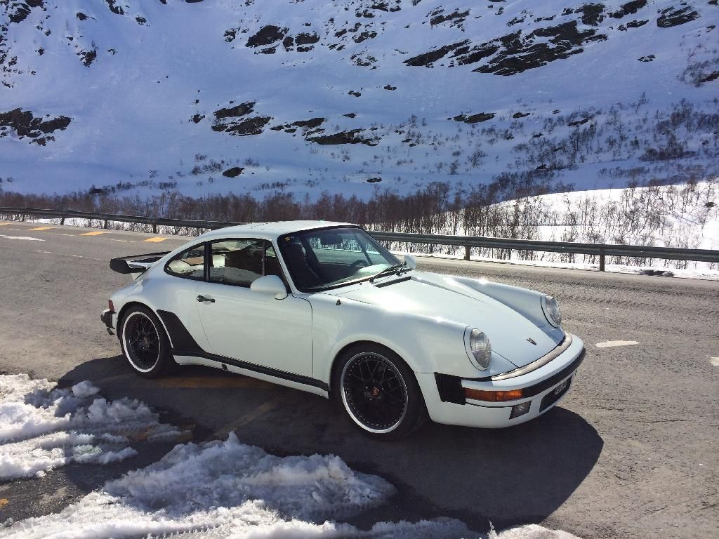

Looking at new wheels to my 1978 930 and could need some advise from you guys.
Like the wheels i got today, but need big spacers to use them. Cant remember but i guess the spacers are 2" or more.
Would like to buy new ones so i could remove the spacers, or at least buy smaller spacers.
I could need some advise to find new wheels, but also which offset i should use on the new one.
the ones i got today is 18", and i think i will go for 18" on the new one also, but i would like 8,5" in front and 10 or 11" wide rear.
First a pic of the car as it is today
I like the lip at the rear wheels, but it could be bigger on the new ones.

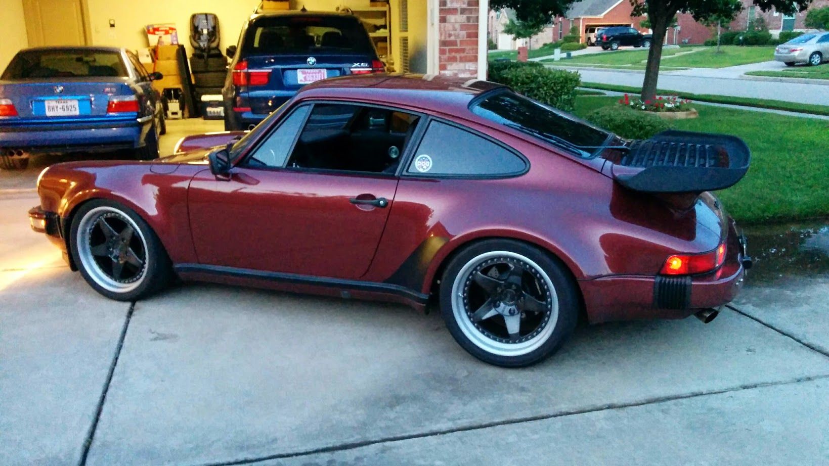

Really like the Work brombacher wheels on this car. Anybody knows the dimension on these wheels?
I also like these two wheels.

Your existing wheels look like 3 piece. Why not get correctly sized barrels?

Personally and especially to have one more wide selection of tyre because 17 " is now very limited, if I had to one day put other wheel rims they would be 18x8.5 and 18x11, for of 235 and 295 sportcup2. I adore Ascari at LOMA.

The bottom two cars likely have RH wheels (made in Germany). They make a replica of the Speedline wheels found on the 1994 Turbo 3.6. Their website (or at least the version for America) indicates they have a figment already figured out for the 930.

I would change the barrels if it was possible, but these are copy wheels of some kind, and the bolts are made of plastic. Cant remember the brand, but not original 3 piece wheels.
I could easily go for 17" instead but haven't found the right wheels yet. So i should go for 9"-11" if i chose 17"?
Feel free to put in pics and dimension of your wheels and please add your offset.
No problem for me with a small spacer, but today I have the original spacer and then another one on top of that.
I can't remember since i don't have the car here, but i think offset on the rear wheels are something of 50.
