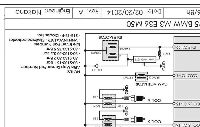

I got a hint on how to use the 3 wire idle air control valve from the manual. They have a diagram for a BMW adapted to a 3 wire IAC. They use a mosfet transistor to invert the PWM signal and have a freewheeling diode. They also use a resistor. Should be easy.

That diagram is in the Infinity manual for the BMW example wiring diagram. I will give that example a try (need to figure out what it looks like with real components though) as I am not sure what the schematic actually means. :confused:
