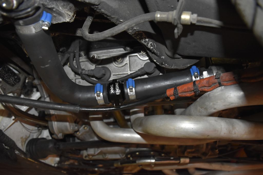

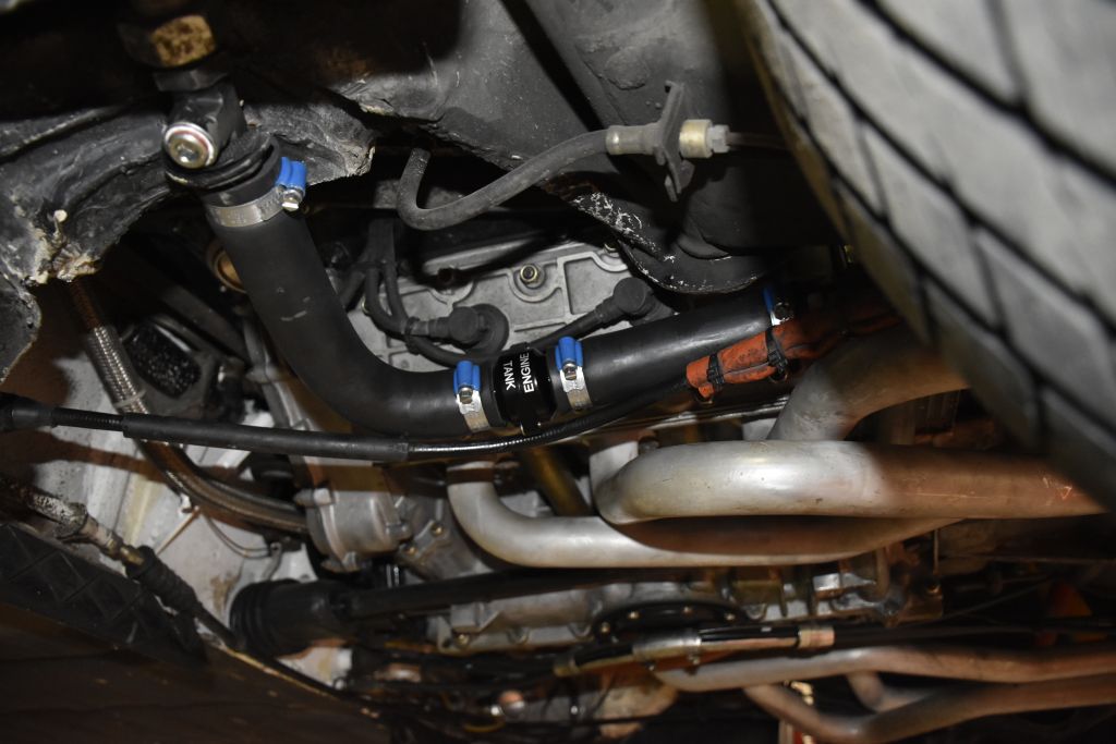

Tank to engine I put in a Rothsprort oil check valve, using 911 S- hose which is a total mod to the 914. I made the T- fitting with an oil drain which adapts Cohline to Porsche S-hose that I cut for this application and the cooler I TIG welded a 1"NPT elbow to the return tube and made a 1"NPT to S-hose adaptor. The Rothsprort oil check valve came with two ABA (blue) hose clamps, way better than regular hose clamps and they don't cut the hose. I got the two extra ABA hose clamps from Belmetric, I'd have no issue using the smaller ABA clamps on FI.

Well, the tank to engine line isn't a pressure line.
Some years ago, on another forum, someone wrote about the pressure he found on the scavange to external oil cooler line - he had somehow inserted a gauge. It was much higher than you might think for a line which topologically ends up in a tank at atmospheric pressure, or close to it. Lots of friction in the lines and fittings, I guess.
I do know that racing organizations (at least PCA ) forbid use of hose clamps on pressure lines, and that would include the scavenge line.
If you want to use the braided stainless or the aramid (which sounds reasonable in these applications, given that stock is rubber and doesn't need the protection of the steel sheath), you could use AN fittings on each end, and adapters to to the metric ends. I did that when adding a center oil radiator up front.
But that might be more expensive than just getting the new lines.
