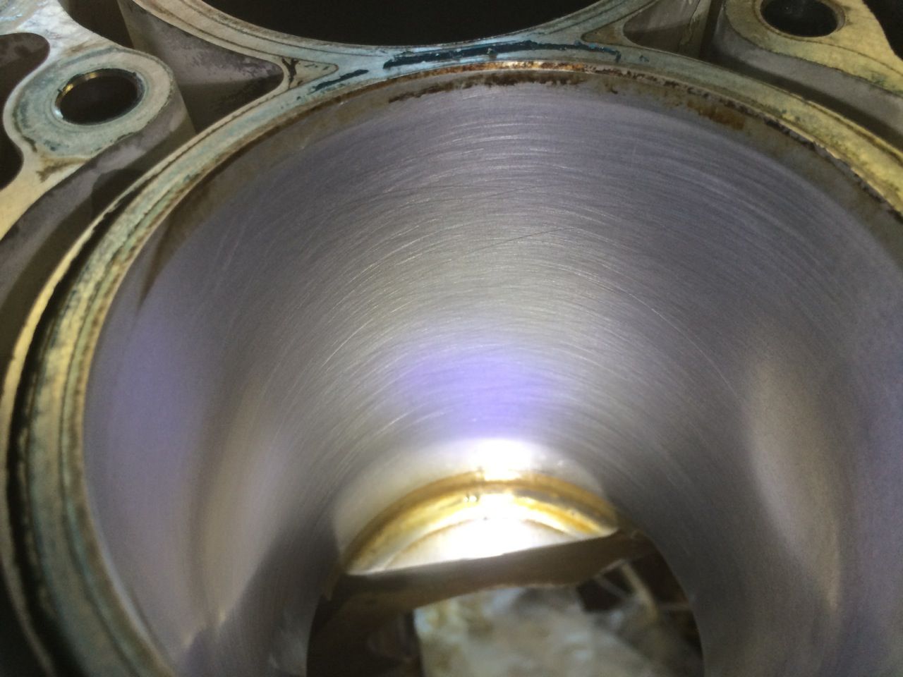

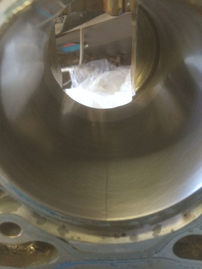

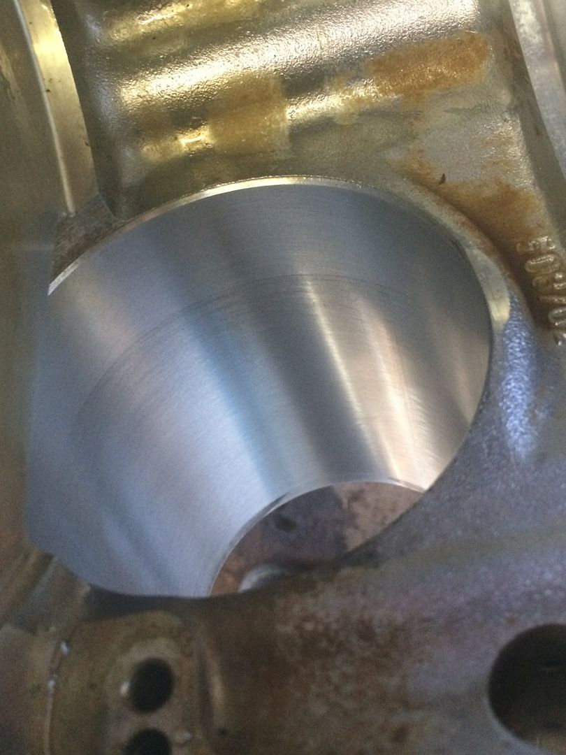

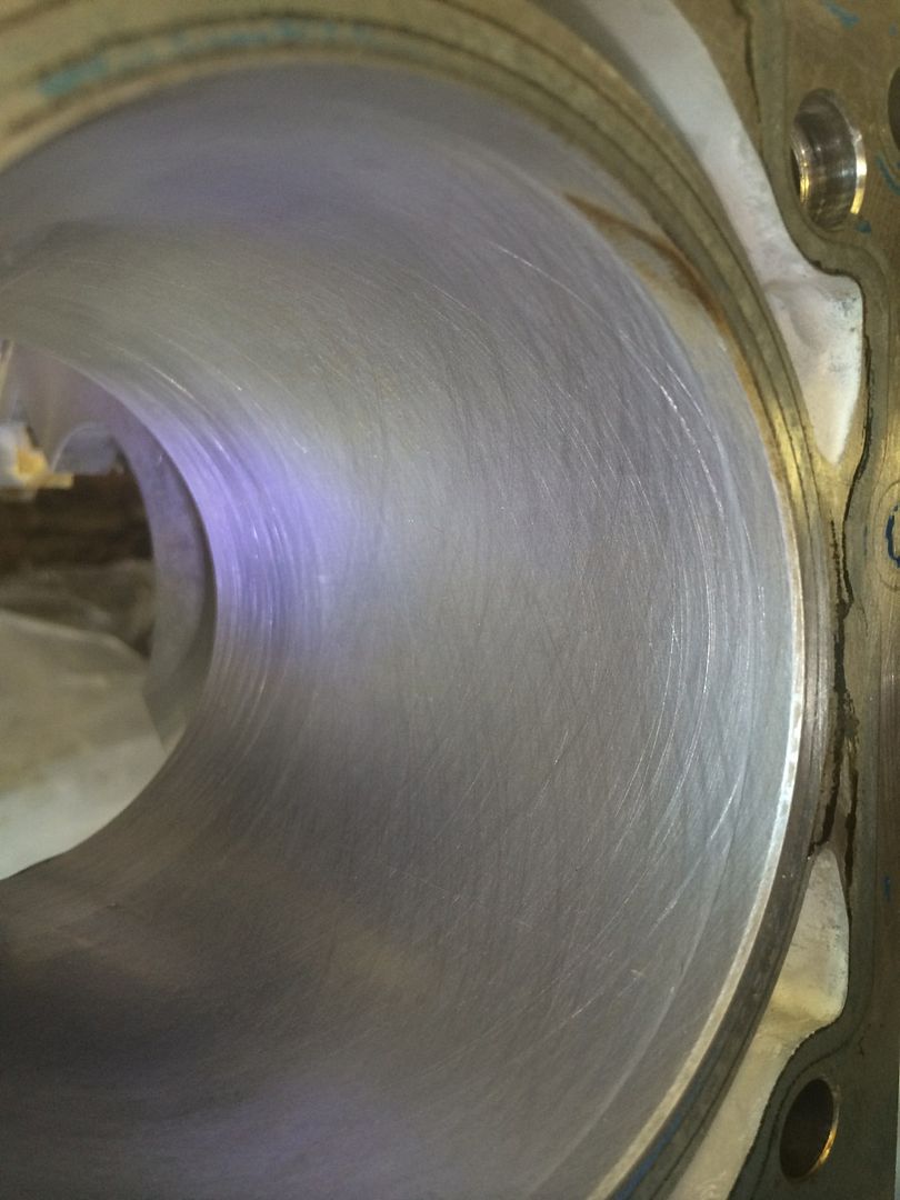

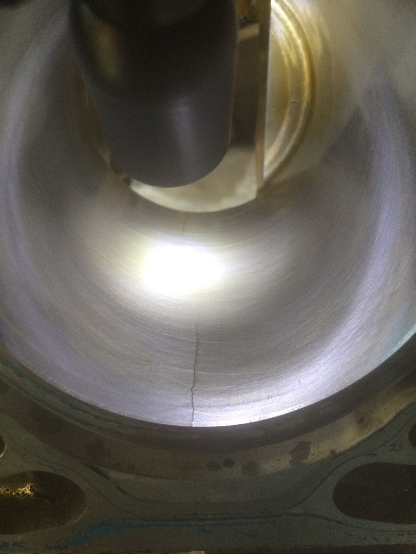

Alright everyone--here are a few pictures from today. Luckily I had an old block to play with, so I came up with a few different times/speeds to try
First try of the day, about 30 seconds, relatively slow speed on drill. Ignore the crack at the bottom. That's why this is a test block afterall
#1
http://i1117.photobucket.com/albums/...t/IMG_5138.jpg
http://i1117.photobucket.com/albums/...t/IMG_5140.jpg
http://i1117.photobucket.com/albums/...t/IMG_5149.jpg
#2--went a little longer on these and I think my pads got dirty as the scratches look deeper to me
http://i1117.photobucket.com/albums/...t/IMG_5161.jpg
#3--this is where I went all out, higher RPM on the drill, and well over a minute for sure. It was the last one I did as well, and I noticed some silver'ish color on the pads that I think I really should have been keeping clean.
http://i1117.photobucket.com/albums/...t/IMG_5177.jpg
And lastly, this is a view from underneath for what I thought were the best ones
http://i1117.photobucket.com/albums/...t/IMG_5188.jpg
HondaDustR 11-10-2013 09:29 PM
I have a feeling you schotchbrited dry. ? Make sure to use lots of oil on the cylinder. I haven't read my posts in a couple years.. these pictures are a good comparison for what you want. http://forums.pelicanparts.com/4921739-post572.html
These specs are what you want now that I've properly refreshed my memory. 45 sec, minimum hone tension, ~120 rpm for scotchbrite, followed by two AN30 runs, ~80 sec each, high hone tension, cleaning and applying fresh paste mix for each 80 sec run, same rpm, but search for my rebuild thread for the whole enchilada. I dont have the link handy atm.
safe 11-10-2013 10:58 PM
Looks way too rough and shiny.
From what I gather, alusil should not have any cross hatching.
