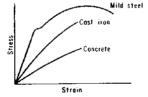

patkeefe 03-09-2009 05:57 AM
Stress Strain
The ARP rod bolts are similar to the curve in the following link:
http://darkwing.uoregon.edu/~struct/courseware/461/461_lectures/461_lecture24/461_lecture24.html
Once you get past the "top of the straight line hill", you are in the plastic range, which means permanant deformation. An ARP rod bolt is essentially junked if you pass this spot, and further torquing (stretching) will result in "necking" of the fastener. The limit is, as ARP says, around 0.0115" stretch, which does not correlate to torque for many reasons (there is a lot of good info here on ths board regarding this).
Engines cost, what, $7000 to build? Buy a micrometer for $50 and check the stretch. Very cheap insurance.
http://forums.pelicanparts.com/uploa...1236603214.gif
Pat
Pat
The limit is higher depending on the ARP bolt you have- they have about 5 different ones for Porsche so anyone reading this should refer to the ARP site where part numbers and stretch limits are noted. If you measure .0124" and the upper spec happens to be .0122", I wouldn't sweat it. I would imagine ARP leaves enough on the table that the bolt won't explode your engine.
