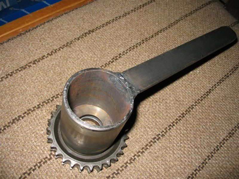

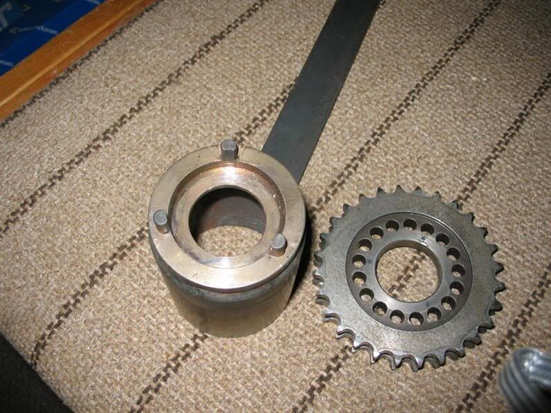

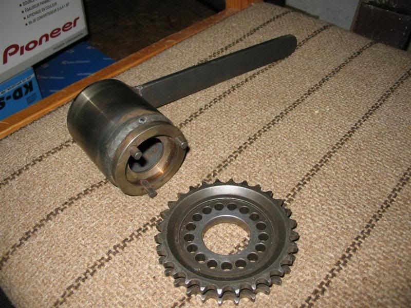

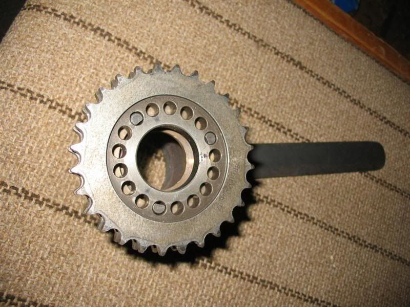

Peter you wrote:
"By the way, if anyone ever needs the tool for setting the cam/chain timing, I had one made, and your welcome to borrow it. Without this tool it is impossible to do."
What does this tool look like? any chance that you could take a photo of it and post it here- thanks Greg
P.S. I would take you up on your offer if I lived a little closer.
peter915 06-04-2006 01:16 PM
Greg,
Gi-day mate - a fellow Aussie!
Struth cobber - !
See the following photos.
http://i79.photobucket.com/albums/j1...0742Medium.jpg
http://i79.photobucket.com/albums/j1...0743Medium.jpg
http://i79.photobucket.com/albums/j1...0744Medium.jpg
http://i79.photobucket.com/albums/j1...0745Medium.jpg
A cam sprocket is next to the tool.
Tool has a hole in centre for Bolt and socket (19mm I think?)
Makes it a breeze.
SmileWavy
