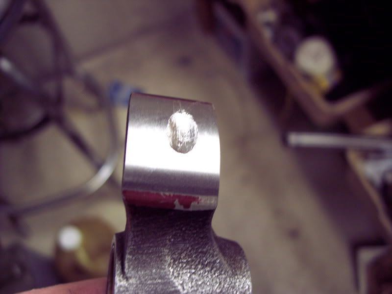

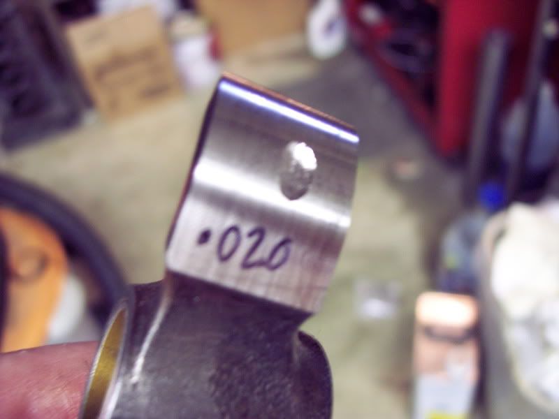

cgarr 05-10-2010 02:03 PM
Here is a rocker I ground out .040 and took off .030 and it still maintained its original hardness, however I would not use one that had that much taken off, they get a bit thin.
http://i30.photobucket.com/albums/c3...1/100_8534.jpg
http://i30.photobucket.com/albums/c3...1/100_8536.jpg
http://i30.photobucket.com/albums/c3...1/100_8537.jpg
hcoles 05-10-2010 02:33 PM
Craig,
you took 0.040" off to start with and then an additional 0.030" per the pictures you posted and the material was still hard.... curious how you measured the hardness, do you have one of those Rockwell diamond stylus machines? I haven't run one of those since college days. There are likely many other ways to get hardness that I'm not familiar with. I think you can even use a file and get a good idea. Excellent work, this means there is a lot of meat to work with.
Even if you confirmed there was only 0.030" that would be a good amount to work with for a couple of 0.005" passes.
Thanks,
-Henry
