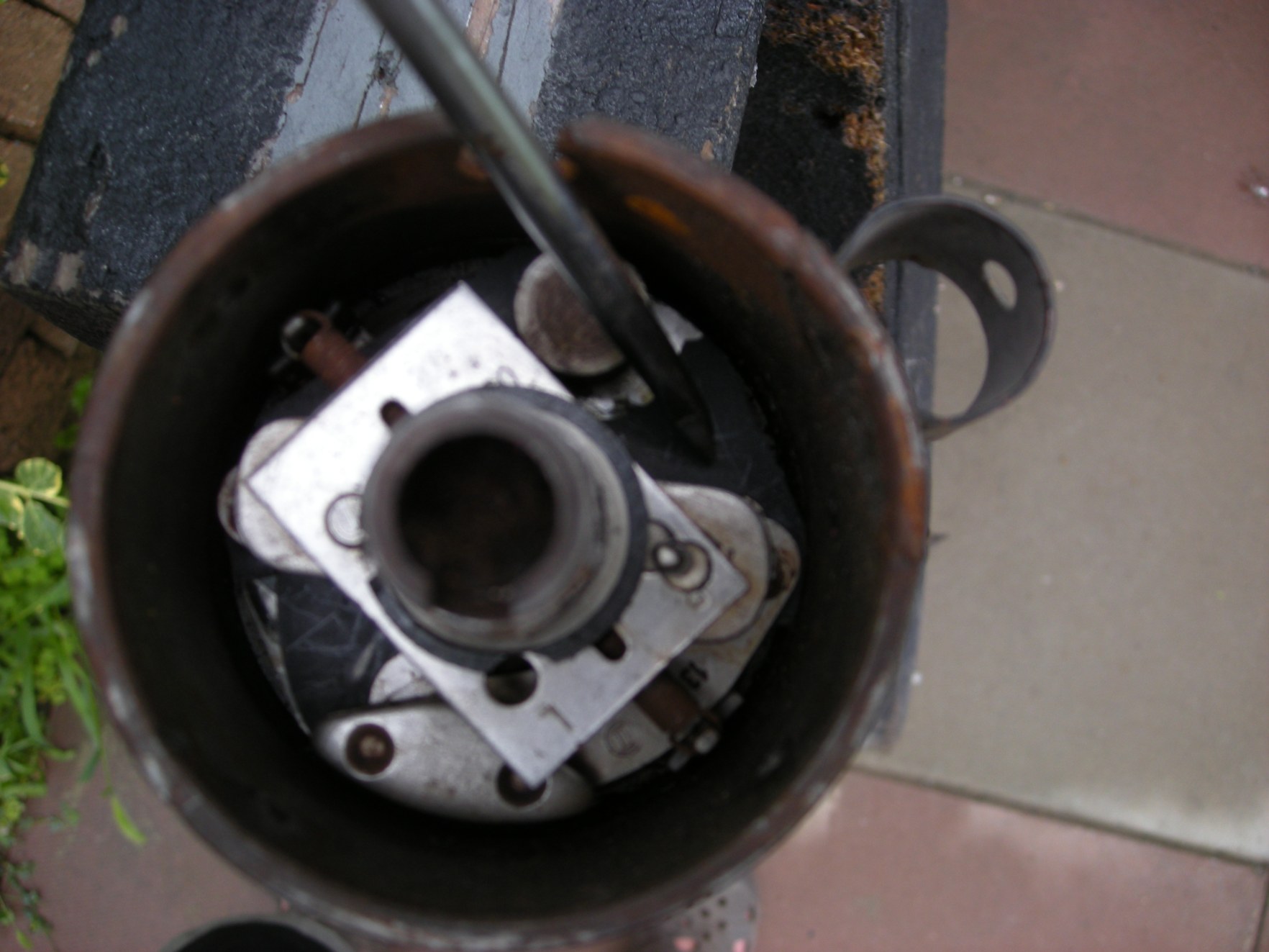

I have a 2.0s dizzy, I believe there's a black hardened steel (cam?) plate, under the counterweight, that looks broke. I can push the bits around with a screwdriver tip, the counterweight is flopping. The springs are intact and the shaft is tight. Bit of surface rust (steel body) yellow tag, bosch. #0 231 159 002.

Here's a pic (tip of screwdriver) of what I'd say is broken; (sorry for the big pic)

That broken part is the sliding surface. It's a very thin phenolic piece that sits on top of the metal plate and they get very brittle and break into pieces. This is normal with these older distributors. You can buy a replacement teflon sliding surface from Stoddard. It's made for a 356 distributor but can be easily modified for the 911 2.0 distributor.

Ok I found the issue and I think even I can repair, the phenolic plate has self-destructed and with the help of that diagram and that link maybe it's no longer a core!
I think the CW slipped off the pin. now I need to figure out why.
I got the pins to engage on the weights and they swing proper now, but one pin is shorter than the other...is that correct? I'll have pic's up shortly.

That looks right. You'll see a slot on the plate that hold the sliding surface & weights and the longer pin rides in that slot. Clean it up real good, replace the sliding surface and reassemble and you should be in business. No guarantee the advance curve will be perfect but you should end up with a working distributor.
