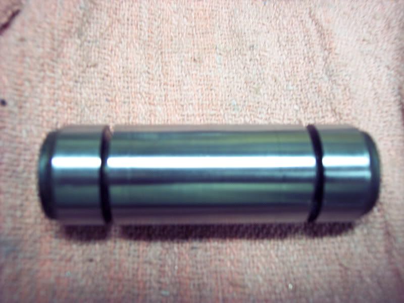

Walt Fricke 03-28-2010 02:26 PM
Shane
How can the redoubtable Craig Garret, or anyone else, "recondition" rocker shafts?
I suppose they could be polished, but mine (I have a large bag full of used ones) are either somewhat scored (despite reinstallation with the "good" part toward the engine), or actually worn to where I can feel the edge of where the bushing ran.
Will polishing remove the normal scoring/wear indications?
snbush67 03-28-2010 04:13 PM
Walt,
I sent them to him with my rockers not expecting anything, they were and still are slightly scored but well within spec.
He simply polished them and mitigated the scored surface.
I really had to work to find the original wear marks and did install using the "good" side.
I used the term "reconditioned" because it sounds more technical than saying "Budget Polish". ;)
Shane
cgarr 03-28-2010 04:33 PM
The shafts most times look worst than they actually are. Most measure out at .7082 and new is .7086 Here is one that was measured then just polished. With the new bushings the shafts should really never again scar up like with the bronze bushings.
http://i30.photobucket.com/albums/c3...1/105_8501.jpg
http://i30.photobucket.com/albums/c3...1/105_8503.jpg
