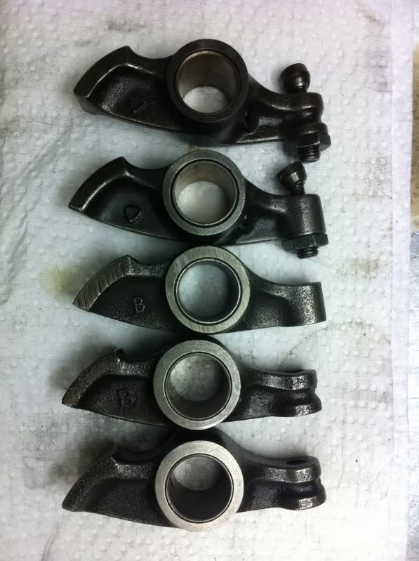

Here's four different styles:
From my fleet (which is now larger by about 11):

Do I recall that the un-bushed rockers (red arrows) were only on some ’68-’69 cars, starting with the RoW ’68 911T?
If so, how did these get in a 930 engine?
Could this be a MM ‘back-date’?

No, sorry for the confusion. I am getting them re-bushed and re-ground. A friend of mine had a valve grinder but I just found out it's long gone..... I had made a tool to press them out so I just went ahead and did so.
