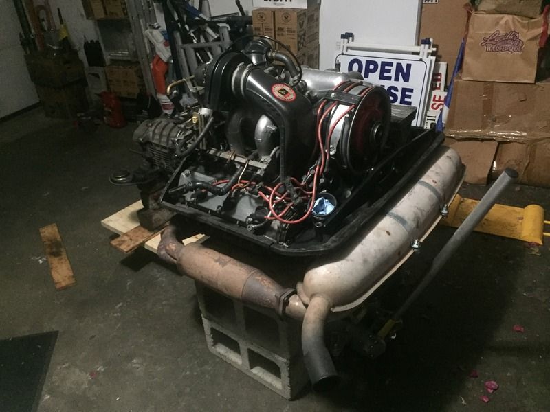

So today is day 1 of my journey to swap the cams.
Of course other items while I am in there but I am trying to regulate myself not to go too crazy.
But before any swapping, I need to check timing, do a leak down test and check everything I can short of cam housing & head removal and/or spliting the case.
Fun Fun

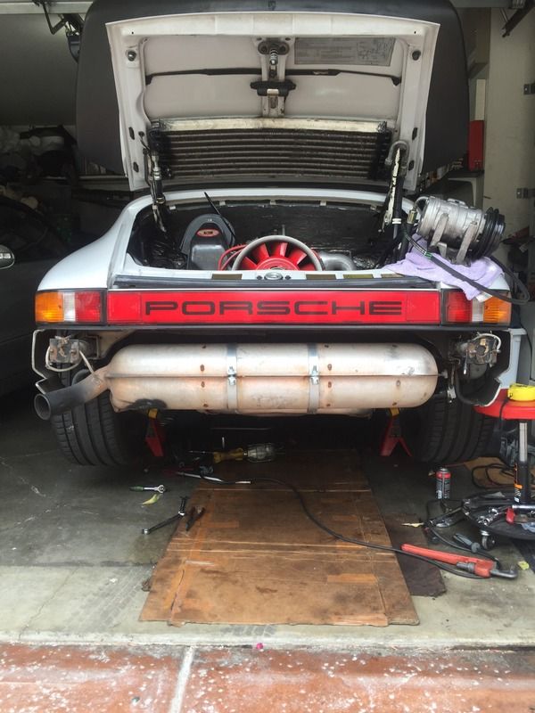

Originally Posted by DRACO A5OG View Post
Well, all is disconnected and ready to drop in the AM.
Do a double check to be sure. There's always something we forget. Commonly forgotten items:
Up top:
-fuel injector harness plug on top of shock tower
-fuel line to pressure regulator or fuel line to top of fuel filter
-ignition coil wire
-bundle of ground wires ganged on the intake manifold runner
-O2 sensor harness plug
-three harness plugs on left side of intake manifold for two timing reference sensors and head temp. sensor
-breather hoses from oil tank to throttle body elbow and/or engine case vent
-charcoal cannister hose to back of air filter housing
-cruise control cable & vacuum hose
-PCV valve hose
-various harness plugs: idle control motor, airflow meter, throttle position sensor, etc.
-bunch of A/C stuff
-large multi-pin harness connector from engine to fuse panel on left side of engine bay
-brake booster vacuum hose
Down below:
-throttle rod female ball end socket on transmission bellcrank
-clutch cable
-transmission ground strap
-speedometer sending unit wiring
-oil scavenge line union ahead of oil tank and S-hose at oil tank
-starter (+) hot lead from battery (disconnect battery so you don't short to ground and start an unintended welding project....... )
-heat exchanger hoses
-remove rear sway bar
-remove shift rod coupler cone screw and shove coupler off shift rod
-CV joints
Good luck. We're all counting on you.........

Here she goes, ready to drop:
Geez, messy work area
LOL, pipe wrench to fix loose bumper strut mount, freakin PO did not put the spacer in the back

Dropped and Ready to Rock & Roll
A little behind schedule due to life happenings, not complaining, very blessed to say the least.
