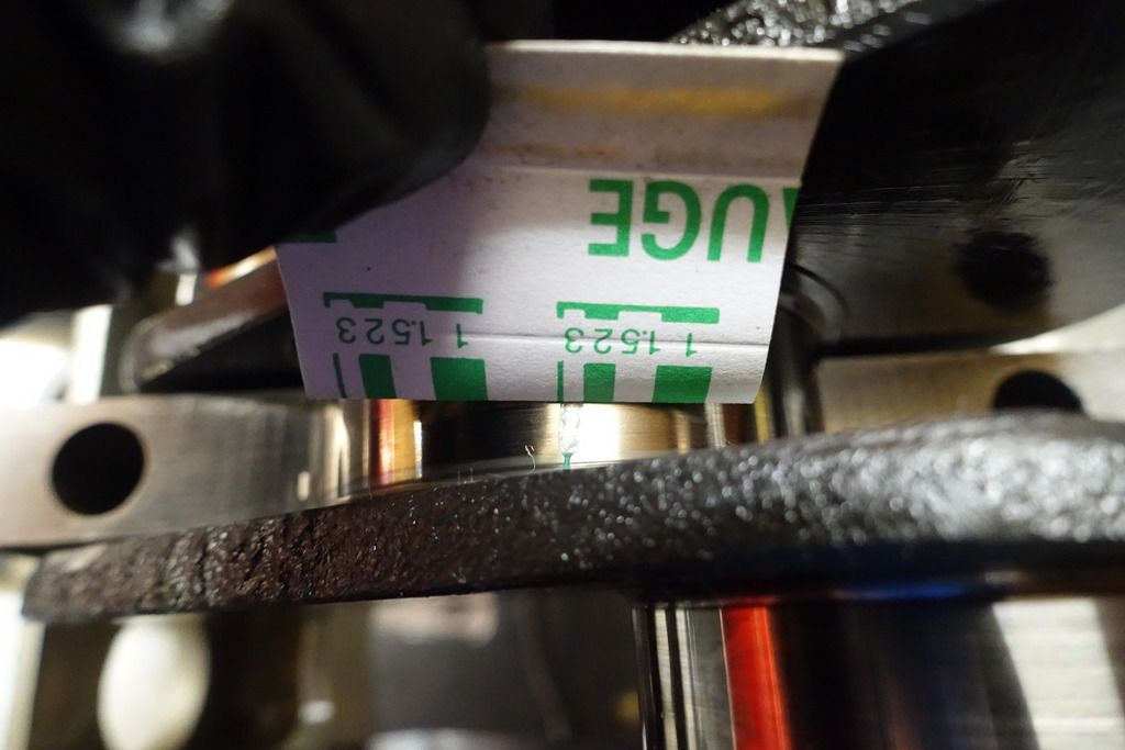

I have pulled my 964 motor down to fix some oil leaks between cylinders and the case.. so, now I have the case apart and thought it prudent to replace the bearings.
My current bearings are original and have travelled approx 65k miles. They are in very good condition, but seeing as a new set of Glyco from Pelican Parts are only a few hundred, it seems silly not to change.

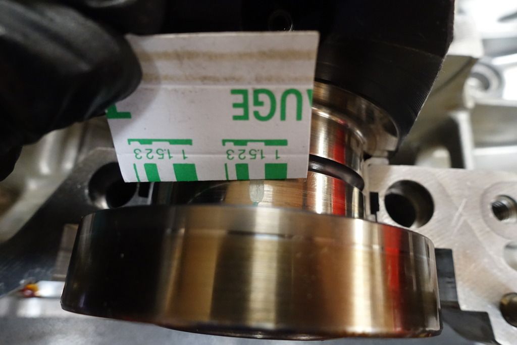

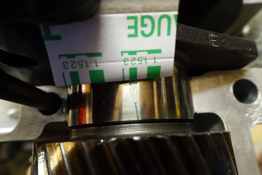

Well, I did a dry run, and used plastigauge to check my clearance. To my surprise, my clearance came back at 3 thou of an inch; this seemed a bit more that I would have thought.
So I pulled the case apart again, re-installed my old bearings, and ended up with 2 thou.
Can it be that my NEW bearings are thinner than my old bearings?
Using my digital micrometer with a ball bearing on the anvil, I checked some of the bearings and on average, my new bearings measure at 2.49mm and my OLD bearings measure at 2.50mm... 0.01 of a mm difference.
I am borrowing a bore gauge from work, to try and be more accurate, but what would you do in this position?
I am contemplating using the old bearings... at least I get the thou back. The car is just a weekend driver.

Hi Mike,
Firstly I'd advise you to get a reliable micrometer to measure the bearings, it's reasonable to presume that a new bearing would be a tighter fit than an old bearing.
Also from the picture you posted, it looks as though the plastiguage has only crushed on half of its full length, I would have thought that the gauge should have crushed evenly throughout the full width of the bearing.
I've never used this plastiguage to measure clearance before so hopefully someone with experience of using this will come along and give their thoughts but to me it looks as though roughly 50% of the gauge hasn't been crushed which would give a very excessive clearance at the uncrushed part (I'm going by the first pic you posted)
Good luck but don't build it back up until you're sure things are ok.
