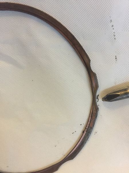

totle 05-11-2017 06:12 AM
I took the cylinders apart anf found a faulty base gasket.
Cylinder are JBR steel cylinders. JE Pistons. Bare gasket is 1mm copper gaskets. ( to get correct CR)
I was running hot when my fan belt tore off during a track event last autumn. I had some laps before I noticed.
Cylinders and pistons are fine, No harm there.
Base gasket on cyl #1 had slipped out a bit and was the cause of the leakage.
Replaced all base gaskets on cyl #1-3 since that side was off.
Engine is now back in the car. Some wired left to connect before startup again :-)

JFairman 05-11-2017 09:07 AM
Put a thin smear of Green Curil T or Blue Hylomar on the base gasket and mating surfaces before installing and it shouldn't leak oil.
Those two sealants never dry so when tightening the head studs a little sealant may squeeze out and then you can clean that off easily with wash Lacquer thinner, Toluene, or Acetone on a rag.
Then you know there's enough sealant in there to hopefully make a lasting seal after the motor goes through heat cycles and cools off again and again down the road.
Best to use new copper base gaskets since they get squished a little and they're not expensive.

totle 05-12-2017 01:31 AM
Engine started up and no oil leaks :-)
