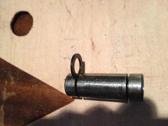

In the process of assembling a motor and cleaning all the parts.. this is the worst of the rocker shaft bores (yes, that is a BIG gouge) .. looks like it has been abused by an idiot.
I acquired the motor in pieces so can not tell how bad it leaked, if at all.
Would some sealant in addition to a seal, be sufficient?
Can it be welded and re bored?
Or do I need to look for a replacement?
Any thoughts?
Mike

Hi Mike..it looks like someone either had a stripped shaft bolt and tried to use a sharp punch to get it out and missed.
Of course the best is probably new tower.But in your location possibly hard to get.

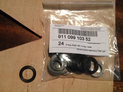

Clean it as best you can and get your self rocker arm shaft o rings.Once you have it look at the alignment and if you can get the shaft with the o ring on it before the scrape?
My feeling yes you can .Then you would have no oil leaks at all.
This is the part you want to order...
here is the shaft located with the o ring before the scrape...my not to good drawing
here o ring goes here
i hope this helps
Ivan

That's the wide boss, so the shaft is recessed into that bore and sticks out of the other side just a bit, so if the surface is still smooth beyond that rough area, you might get lucky. Hard to see in that picture. O-rings for sure, anyway.
