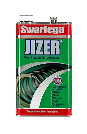

Don't use paraffin - ask me how I know. I resorted to buying some when I couldn't get to anywhere to buy anything else. It cleaned really well for the day or two I was actively using it, but came back to it a few months later to find that the rubber hose on the cleaning brush (attached to the metal nozzle) had gone rigamortis-like hard. A porn star would've been proud.
In fairness, it did warn against using it, I thought for flammability reasons. Thankfully it didn't wreck the pump.
'm now using Swarfega Jizer which I have to say, I'm really pleased with. Is it as good as old-skool solvent based cleaners? No...but way better than water based crap. It also claims to leave a coating to protect cleaned components from corroding/rusting afterwards. Can't comment on that, I always then clean again with brake cleaner before fitting the part.

Hahaha!!! That really did make me laugh. Yup...exactly...I think, lol!
I do forget sometimes that there's some words that just aren't part of the US vocabulary. ("whilst" was one that somebody picked me up on a few years ago - I chuckle every time I say or type it now)
Tizer was indeed a British soft-drink in the 80's, I loved it
...I think it's still around but I've not seen it for "yonks" The stuff I actually meant was Jizer, as you say, made by Swarfega, thus...
Now, it does actually look like flat-Tizer, very red in colour. I'm sure that's a coincidence rather than re-purposing of old soft drinks....
