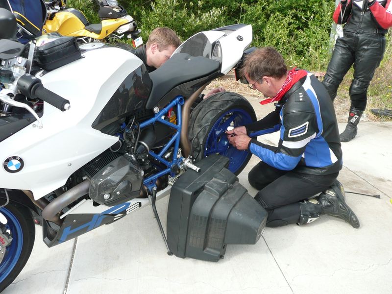

Patch to get home, replace ASAP.
Not mine, but who remembers this one?
tm
(R12, R11, R1) + 00 then S, S, /7

The other pic that should be shown is Sergio’s bike on the trackstand that Tuna found on the roadside! LoL
I have that one, too. Gimme a few minutes.

Best use of a tube tv I've seen in a while.

Ha, I thought it was a 1200S pannier that was extra deep because of all the space between seat and tire.
