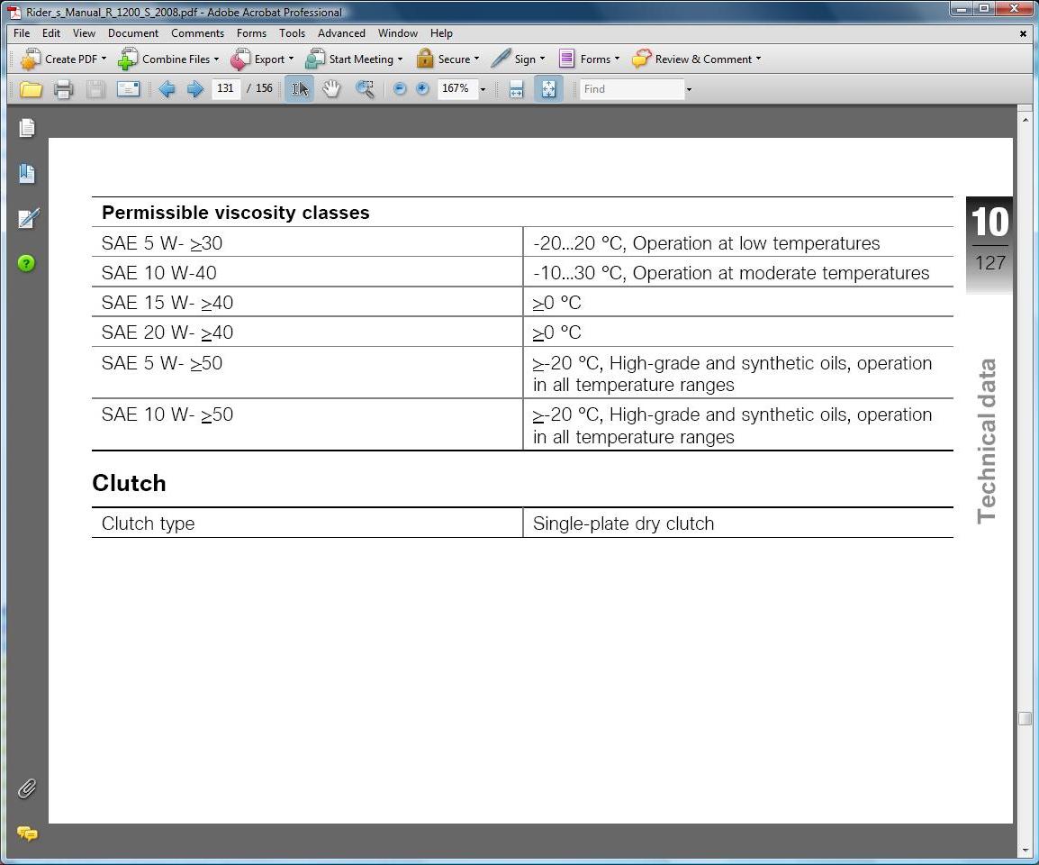

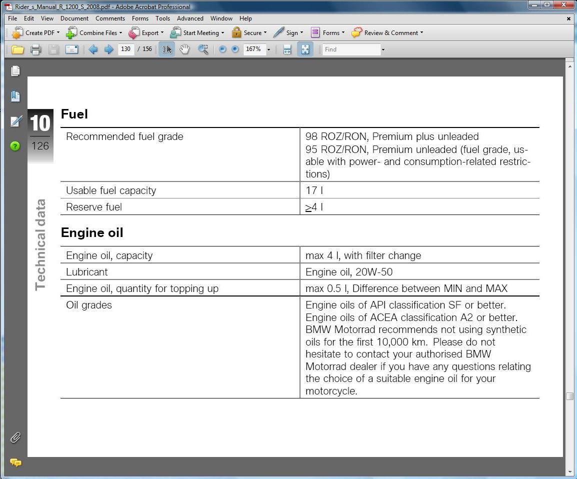

Old 01-25-2012, 12:07 PM
Location: Fort Mill s.c.
Posts: 2,631
Here is what I use.
2005 Boxercup, 2013 R1200GS Rallye, 2011 Triumph 675 Daytona, Honda MB5, 2011 KTM300xc, 1975 Bultaco, 1992 Beta, 1972 Aermacchi
