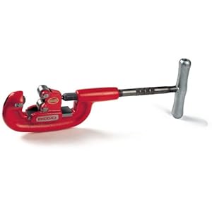

Since I have been on the forum I have read countless post telling to check filter at every oil change for metal particles that may be signs of possable IMS failure. So with the spin off type filter is this not a bit harder to do? Or is this an upgrade you do after IMS retro fit, is having spin off filter really that much more superior than oem?

I've had the LN spin on filter on my car since they were introduced. Little more effort to open the filter for examination, but worth it because the element is much better at particulate filtration (please refer to the LN website for details). Also highly recommended you drop the sump for examination...bit more effort, but worth saving your engine if any foreign matter is found.

Not hard at all, just need a filter cutter tool.

Looks like a nicely made tool, whose is it?

JFP, You have helped me so much I went looking for your bogie. I believe this is it.
Amazon.com: Proform 66490 Oil Filter Cutter: Automotive

I also thought is the Proform, but was just trying to confirm it. There are several makers of these cutters, some nice, others not so nice; this happens to look particularly well made.....

Thanks fellas, question asked answer given. I have found my next project, will drop sump and also check that out when I do my IMS sometime this week. Filter cutter reminds me of pipe cutter when I used to help pops do plumming jobs, anybody try using a large pipe cutter from home depot? Might be cheaper.

Tubing cutter (decent quality) in the 2-4 inch range is approaching $300............

I will check for the manufacturer and it was about 60 or 70 maybe. Should last you a life time. It appears it may have been made/ marketed by Proform, but there could be knock offs or maybe a different company. No issues to date and i have had it 4 of 5 years.
