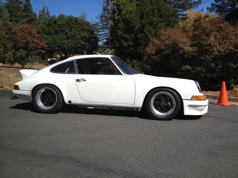

Exterior Steel rear RS flairs.
Duck tail
Custom FG rear bumper.
Custom FG front bumper.
Carbon Fiber doors and trunk lid.
Rear PORSCHE reflector.
Plexi rear quarters and rear windows
Steel doors can be swapped when needed

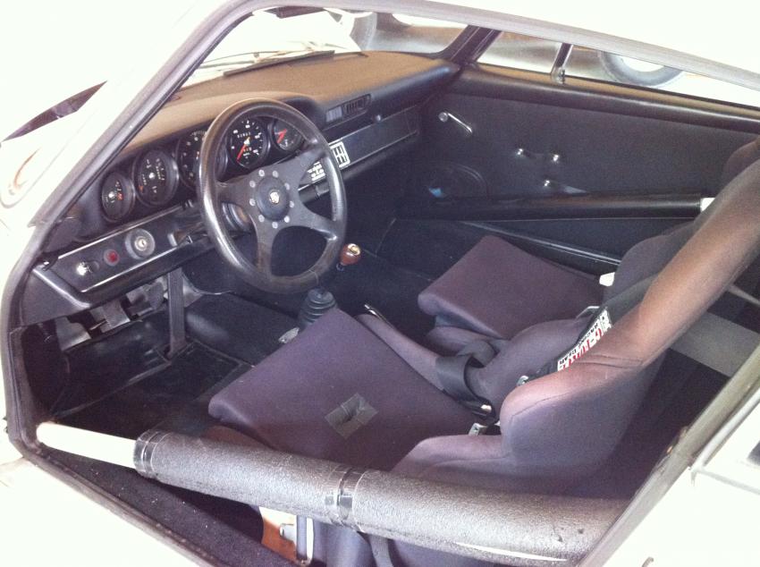

Interior MOMO race seats with custom covers.
Six point custom roll bar.
Six point race harnesses.
Removal of sound deadener
Light weight carpets
RS door panels
Rear seat delete

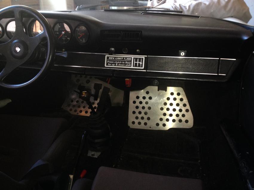

Heater control and radio delete

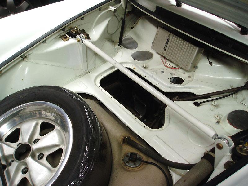

Strut brace, custom RSR style
