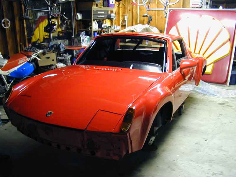

History Accuired in 2000, it was my second car that started my love for Porsche automobiles across the board. I rebuilt the 1.8L L-Jet engine, but had to install Webers on it because the mechanics cost way too much to try and repair the bosch system. Rebuilt the motor a second time with more upgrades, but that only lasted a couple more years. I purchased a 72E engine in pieces from a friend, and rebuilt it.

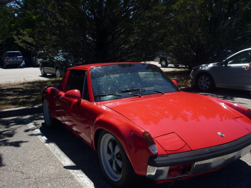

I need to get a new pic, I recently cut & rubbed the car including a wax job too.
Adj. coil over rear, and Bilstien RSR fronts. Boxster monoblocks w/my billet CNC adapters.

Exterior All body work I did at a local JC. all rust removed, fiberglass flares, painted guards red.
