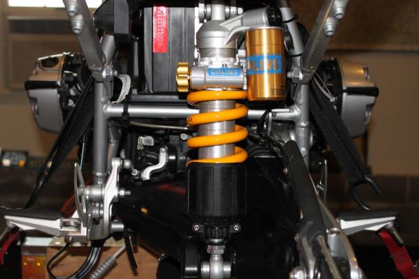

Suspension ProPilot Racing suspension mods: Added remote reservoir with compression dampning adjustment to front shock as well as hydraulic spring tension adjuster. Rear shock added hydraulic spring tension adjuster. Changed front spring from 68kg to 72 kg. Changed rear spring from 170kg to 190kg. Ohlins fluid changed during mods.
