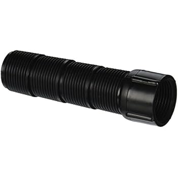

If the heads are not on a section of flex or funny pipe, the easiest way to raise them is to use an "extension nipple":
They are "poly", which is the nice soft stuff that is easy to screw in - and more forgiving than(for example) the gray colored schedule 80 stuff that some nipples come as.
That one pictured is a 3/4" - and they also come in a 1/2". You will know which ones you need after you unscrew your head and look at the inlet at the bottom.
These nipples are different than 'normal' nipples because they have a male on one end and a female on the other - so when you unscrew your head....you have one end that is male and one that is female....and this nipple goes back in between the two....and just like that....your head sits higher than it was. Note also the nipples are segmented so you can cut to desired height.

Based on your post, this would be the easiest and most efficient path to take to raise up your heads. Your goal obviously is to raise them as high as possible without being so high that the mower blade will hit them.
Make sure you pack the soil down real good around each head as needed.
