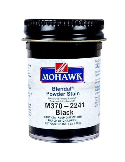

Originally Posted by A930Rocket (Post 10568825)
Is there a way to make JB Weld darker by adding something?
If you look at the ingredients, I would thing some more carbon black would not compromise the compound. You could grind up some BBQ bricketts and screen the powder but I'd be somewhat concerned about the additives like the binder. You could do the same with real charcoal I suppose. However, there are black pigments available. I have some that dissolve in water which I then add to alcohol so it becomes soluble in shellac. IDK if that would mix properly with BPA but the raw powder likely would.
https://images-na.ssl-images-amazon....IL._SY550_.jpg
10 bucks. Your local art supply will have this too.
A930Rocket 08-24-2019 11:19 AM
Thanks, Milt. I thought about it last nite and wondered if the leftover black powder from my big copy machine might work.
I’ll do a test next week.
