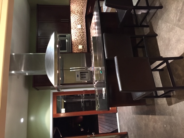

Here's a remodel I did for a fellow Porsche junk yard owner here in LA (no, not LA Porsche dismantler) about 7-8 years ago. I came up with all the color and materials but the wife vetoed the splash color at the end and had this installed instead. It came out great, but I wanted some blues and greens in the splash to get away from the typical brown kitchen to pick up a little of the floor color. Instead she opted for green walls. Everyone loves the stone floorhttp://forums.pelicanparts.com/uploa...1569262907.JPG
