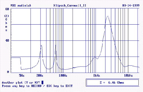

Well, you may easily know more about these matters than I. In my experience resistance is virtually always below the rated impedance of the speaker. the 6.2 measurement, in my experience, is highly unsurprising for an 8-Ohm speaker.
And.....the actual impedance behavior of a speaker is a weird thing which varies greatly across different frequencies. The rated impedance of a speaker is said to be an average of those impedances but it looks to me like it is more of a median estimate. As I mentioned, the impedance curve for a Klipsch Cornwall has been measured as a range from 5 Ohms to 75 Ohms. Here is that curve:
http://forums.pelicanparts.com/uploa...1645653503.gif
I'm not sure how tube amps compare to SS in terms of their impedance behavior, but I know my amp tech thinks it is important. And I think the "Heritage" line if Klipsch speakers (Klipschorn, LaScala, Cornwall, etc.) are essentially designed for tube amps so I suspect tube amps are fine with their impedance characteristics. I do also know, however, that giving a tube amp insufficient loads is a bad idea. Most of them will be damaged if run with no load, whereas a SS amp is perfectly happy at full blast with no speakers connected.
I certainly agree with you that dabbling at the limit of an amp's minimum impedance requirements without fully understanding the engineering and performance of both amp and speaker, but I also think that two engineers might even quarrel about that with the data in hand.
