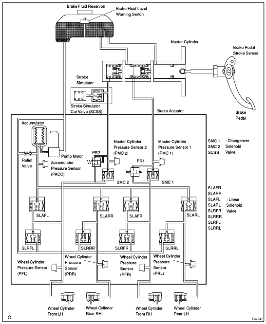

So, if the pump fails, or if certain other issues are detected, pressure from the hydraulic master can be applied to selected braking cylinders, by deactivating the SMC solenoids.
HUH? This is only if the computer senses a malfunction and it thinks the hydraulic pump is failed. The computer still has to release SMC 1 & SMC 2 before non-computer controlled braking occurs, unless there is a general full system power failure, where (I'm guessing here) the solenoids will be released.
This is NOT a full fail safe system. A full fail safe system, using this design, would have a relief valve set up so that if the pressure exceeds a certain amount, it ports fluid directly to the brakes. The SMC solenoids would cutout on malfunction
This is a very bad design.
I've added 2 pressure relief valves (PR1 and PR2) where if the pressure in the MC get high enough, the fluid will port directly to the brake cylinders.
http://forums.pelicanparts.com/uploa...1268198718.gif

red-beard 03-09-2010 09:38 PM
See my above explanation. The addition of the little relief valves would allow manual breaking by simply pushing hard enough.
The better system is a STANDARD master cylinder with pressure sensors which activate the RB system and the break boost system, but the system would simply directly act if the pedal is pushed hard enough, as aways also described.
BINGO! We have a winner. Where is the hard wired (piped) bypass to make this work if everything else fails? http://forums.pelicanparts.com/support/smileys/nono.gif
Silly you! Why would we spend about $300 (for 2 high pressure relief valves as seen in the McMaster Carr Catalog) for each car. We can't afford that! How many would ever really need one? :rolleyes:

Brando 03-10-2010 12:05 AM
After much drinking (and 5 minutes of photoshop) I think I have engineered a solution for the Prius/Lexus/Toyota Hybrid braking system!
http://forums.pelicanparts.com/uploa...1268208296.jpg
So, can I get an engineer's pay now? Maybe I can offer an "upgrade installation kit" for this?
